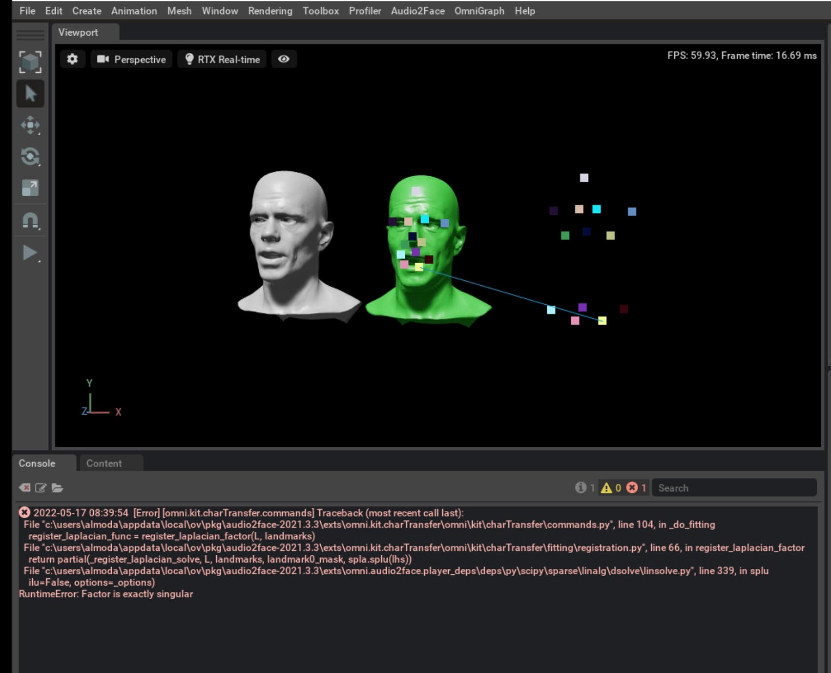

Another issue existed on my model when do the MESH FITTING
Could you give me some advice on this?
I can email you my model if need.
thanks a lot.
Is this the same mesh as what you showed on the circle head shape character?
Audio2face require the mesh to be one continuous mesh. I saw that on the character is that the mouth and eyes are merged to the mesh, but is not connected.
If this is a different model, yes, I can help take a look. You can send to my email esusantolim@nvidia.com
Hi, esusantolim
Thanks for your response.
The previous character with mouth and eyes merged to one mesh work well.
I tried another new mode which has teeth, but the teeth is not connected to the head, like floating in the mouth.
Seems that’s the issue which caused mesh fitting issue.
So any recommendation to solve the issue? Connect the teeth with head? even connect 1 vertex is ok?
I suggest separate the teeth into its own mesh.
If you manage merged and connect the teeth to the skin ,the result won’t be pretty because we on’t have anything in the mouth that would keep the teeth staying rigid.
Hi esusantolim
Thanks for your suggestion.
Separate the teeth into its own mesh, it can solve the MESH FITTING
issue.
