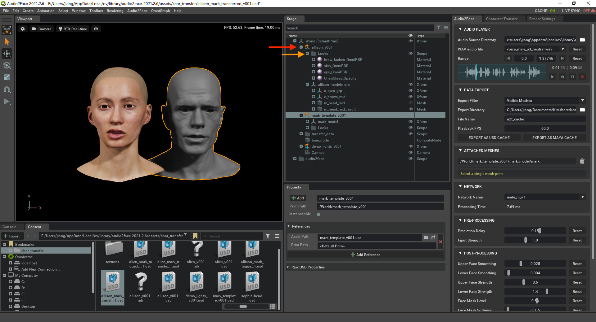

In my model, the “look” folder is under DefaultPrim
while in the allison model, the “look” folder is under the secondary directory
Is that the difference you are referring to?
Where do I need to change this over, in Audio2Face or in Maya?
Hi @jianghaomin80 ,
The Looks Scope will get created every time we create new material in the scene. The path would be under the DefaultPrim. The material itself can be moved or reparented to where ever you want as long as they are not locked (example of locked is when this material belongs to a referenced usd file)
It is normal that you have multiple Looks Scope if you bring in multiple assets that each has their own Looks that contain the materials.
You can assign existing material to your selected object using this dropdown on the Property panel.

below is screenshots in Maya and Audio2Face.
Can you select just your mesh and see what’s under it on stage view?
In your posted image in ov app, I don’t see your mesh listed there, it must have been parented under one of those collapsed group.
