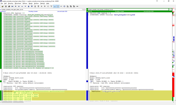

I am having hard time (2 week odeal already) to get the TX1 to boot from SSD. As the title says my setup is:
  • Auvidea carrier board J120 with IMU
  • TX1 module
  • M.2 PCIe NVMe SSD (samsung 960 evo 256GB or Intell 600p 128GB)
First out of the box the kernel r24.2.1 does not support NVME device. I rebuilded it with “CONFIG_BLK_DEV_NVME=y” the SAMSUNG drive will be recognized, for the Intell SSD to be recognized I had to also set the “CONFIG_PCIEASPM is not set”.
I am using linaro 5.3-2016.02 compilers to crosscompile the image and then copy the Image, zImage and content of the lib dir over to target.
I tried to partition the SSD using gdisk, gparted. With the same results. To get the file system on SSD I tried to extract the sample root file system from nvidia site and then use the apply_binaries.sh. I also tried to copy the content of root MMC partition using the guide from jetsonhacks “cp -ax / /mnt/…”
The result is always similar, once I change the “root=/dev/nvme0n1p1” in extlinux.conf the boot process will stuck I can see in the console “Root device found: n” or worse the log will be full of “Buffer I/O error on device nvme0n1, logical block xxxxxx” errors, followed bu core dumps…
I am running out of ideas… any help will be greatly appreciated.

OK, I need some help with this.
I do not know where the Buffer I/O error on device nvme0n1, logical block xxxxxx comming from.
To simplify the setup I did the following:
-flashed the L4T 24.2.1 - just the os nothing else
-rebuild the kernel with CONFIG_BLK_DEV_NVME=y (I compared the configs and only changes are the CONFIG_BLK_DEV_NVME and CONFIG_LOCALVERSION)
So I have NVME support but as side partition and not booting from. If all goes OK I can access the partition no problems. Most likely I will get errors.
see the attached logs ,I removed timestamps to be able to compare them easily. The most complete and error free is system_console_nvme_lspci_clean_10.txt. It is clean from boot to shutdown.
comparing it to system_console_nvme_isomgr_coredump_01.txt I think there are indications of pcie problems:
LPDDR4 Training: Can’t find emc-table node
WARNING: at /data/git/jetson_kernel/linux-3.10/drivers/platform/tegra/mc/isomgr.c:565 - followed by stack
dump
I compiled the nvme-cli tools and checked the nvme smart-log /dev/nvme0n1 , it is error free, no badblocks spares used. The only think suspicious there that the unsafe_shutdowns 116 is very close to power_cycles 118 which I think suggest the pcie/nvme drivers do not handle correctly shutdown?

Other logs attached, in one badblocks -v completes without errors, in another it will spill the buffer I/O errors…
system_console_primary_… are booted with original r24.2.1 image
system_console_nvme_… are booted with recompiled image
Please help!!
system_console_nvme_badblocksFailed_09.txt (96.8 KB)
system_console_nvme_isomgr_02.txt (101 KB)
system_console_nvme_isomgr_03.txt (153 KB)
system_console_nvme_isomgr_coredump_01.txt (101 KB)
system_console_nvme_lspci_clean_10.txt (101 KB)
system_console_nvme_orphants_badblocksOK_clean_07.txt (94.3 KB)
system_console_nvme_short_04.txt (5 KB)
system_console_nvme_shutdown08.txt (91 KB)
system_console_primary_05.txt (91 KB)
