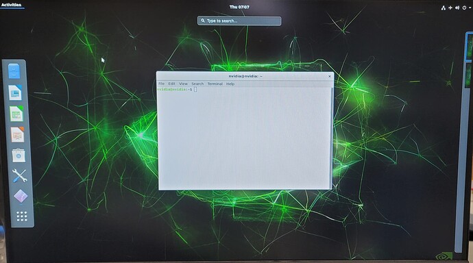

Let’s try to clarify whether this is only to Gnome or even the other X application.
Please disable gdm and directly run initx and see if there would be a screen showing up on the monitor.
gdm disabled using “servicectl stop gdm.service” command, X session started using “startx” command, and a graphical interface came up:
I was able to control the X session using mouse and keyboard, and confirmed that gdm.service was actually stopped just to be sure.
If gdm is the cause of this issue, I would say this seems not related to platform.
Have you ever tried to use jetson devkit to reproduce this issue?
