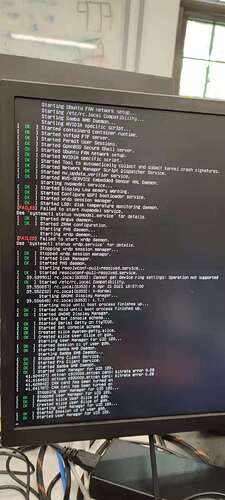

Xavier, use HDMI ,sometimes he screen blinks and you can't log in
We use jetpack4.4 filesystem, have removed the TypeC conversion chip from the board and used A USB-A port. We have found A problem:
After a few restarts, the screen blinks and you can’t log in,but it can be networked into the system,the log of " journalctl -xe" execution is as follows

root@xavier:/sys/devices#
Could you please give me some advice on how to solve this problem? Thank you!
BR,
Xavier kept flashing in this interface, and could not enter the login interface:
Looks like nvgpu driver is crashed. Could you check the dmesg when error happens?
Hi WayneWWW,
Thanks very much for your replay!
While this was happening, dmesg kept printing the following:

Hi WayneWWW,
Sorry for the late reply!
In fact, we don’t know how it happens, right.
No applications are running; it happens during the power-up process, without waiting for.
In driver side ,we modified Camera and patched the real-time operating system patchs.
In our client board, the Type-C interface is removed, USB-A interface is used, and PD chip is removed.
And we tried to remove SOR, but it didn’t work:

[  455.926903] Extcon AUX2(HDMI) disable
[  455.952592] tegra_nvdisp_handle_pd_disable: Powergated Head1 pd
[  455.954540] tegra_nvdisp_handle_pd_disable: Powergated Head0 pd
[  455.955417] tegradc 15200000.nvdisplay: unblank
[  455.956653] tegra_nvdisp_handle_pd_enable: Unpowergated Head0 pd
[  455.956853] tegra_nvdisp_handle_pd_enable: Unpowergated Head1 pd
[  455.959730] Parent Clock set for DC plld3
[  455.968466] tegradc 15200000.nvdisplay: hdmi: tmds rate:148500K prod-setting:prod_c_hdmi_111m_223m
[  455.970109] tegradc 15200000.nvdisplay: hdmi: get RGB quant from EDID.
[  455.970115] tegradc 15200000.nvdisplay: hdmi: get YCC quant from EDID.
[  456.005457] Extcon AUX2(HDMI) enable
[  459.407797] tegradc 15200000.nvdisplay: blank - powerdown
[  459.453690] Extcon AUX2(HDMI) disable
[  459.477191] tegra_nvdisp_handle_pd_disable: Powergated Head1 pd
[  459.478810] tegra_nvdisp_handle_pd_disable: Powergated Head0 pd
[  459.478934] tegradc 15200000.nvdisplay: unblank
[  459.480007] tegra_nvdisp_handle_pd_enable: Unpowergated Head0 pd
[  459.480105] tegra_nvdisp_handle_pd_enable: Unpowergated Head1 pd
[  459.481798] Parent Clock set for DC plld3
[  459.487831] tegradc 15200000.nvdisplay: hdmi: tmds rate:148500K prod-setting:prod_c_hdmi_111m_223m
[  459.489145] tegradc 15200000.nvdisplay: hdmi: get RGB quant from EDID.
[  459.489156] tegradc 15200000.nvdisplay: hdmi: get YCC quant from EDID.

When I execute the SS command, dmesg displays:
[ 1791.834870] tegra_nvdisp_handle_pd_enable: Unpowergated Head0 pd
[ 1791.835053] tegra_nvdisp_handle_pd_enable: Unpowergated Head1 pd
[ 1791.836984] Parent Clock set for DC plld3
[ 1791.844142] tegradc 15200000.nvdisplay: hdmi: tmds rate:148500K prod-setting:prod_c_hdmi_111m_223m
[ 1791.845435] tegradc 15200000.nvdisplay: hdmi: get RGB quant from EDID.
[ 1791.845442] tegradc 15200000.nvdisplay: hdmi: get YCC quant from EDID.
[ 1791.880311] Extcon AUX2(HDMI) enable
[ 1795.249338] nvgpu: 17000000.gv11b          nvgpu_nvhost_syncpt_init:291  [INFO]  syncpt_unit_base 60000000 syncpt_unit_size 400000 size 1000
And does lsmod have nvgpu inside the list now?
nvidia@xavier-rt:/var/log$ lsmod
Module                  Size  Used by
nvgpu                1735188  0
mttcan                 72816  0
can_dev                17148  1 mttcan
can_raw                11086  2
can                    50135  1 can_raw
What will happen if you restart gdm3 now?
How to do that? use "sudo service gdm restart”?
When I execute that command,the desktop is working.
Is this nvgpu driver build by yourself or it is directly pre-built binary from jetpack?
By myself.
