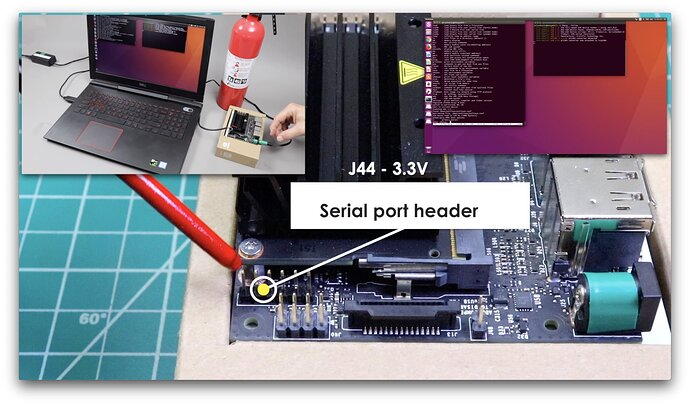

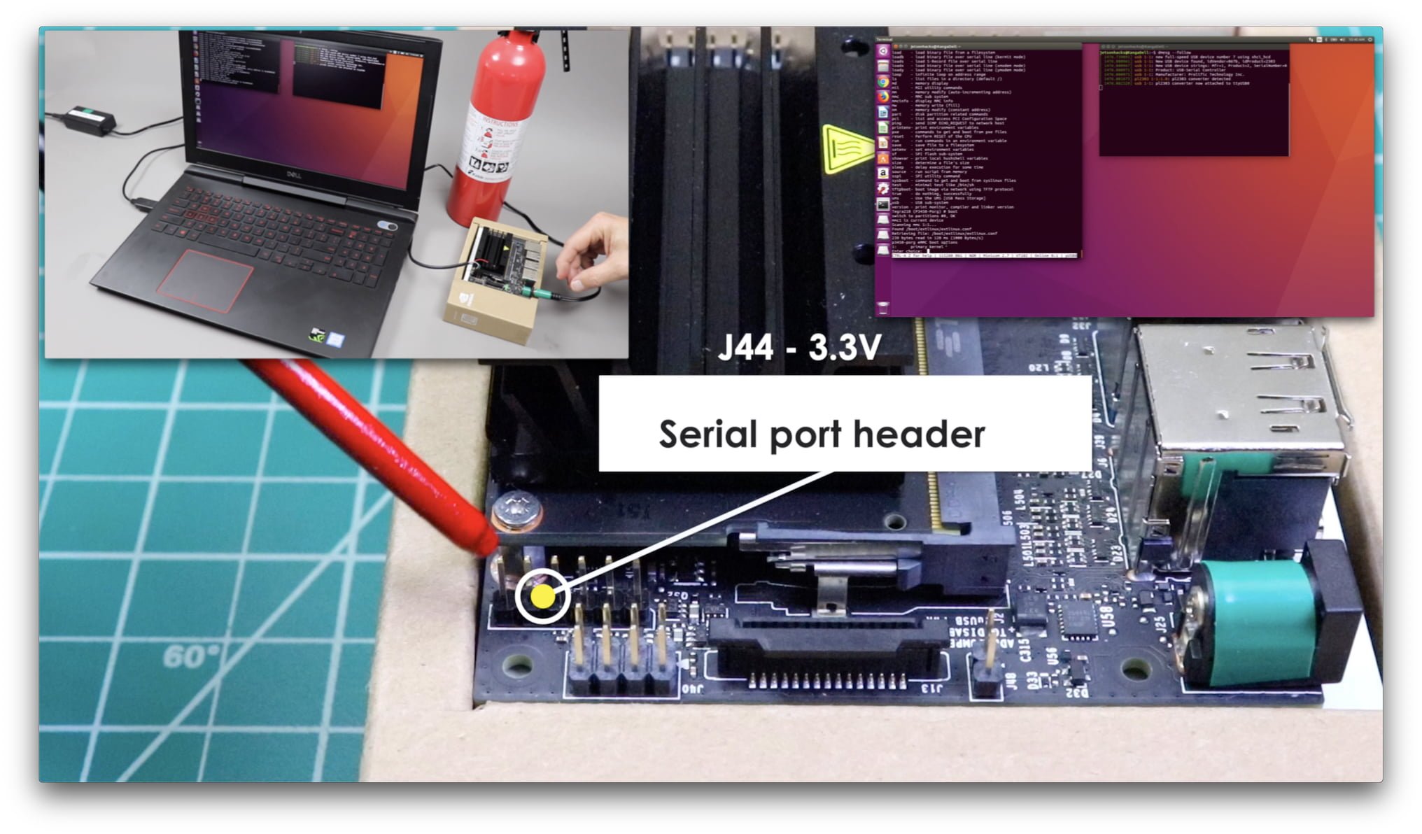

Also, please learn to dump the full log from uart console instead of just pasting a screen photo with panic log.

Then just share us the log from uart.
The real info that would help is the log file. Your description is just for clarify the symptom. The detail still requires the log to tell.
