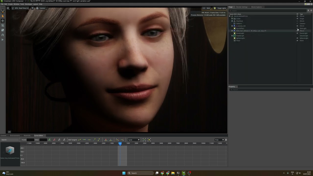

This is a follow up on basically solved topic:
If I use the SSS option, I see a bright tearline on my character:
How can we solve this? its CC4 from Character Creator, exported as path traced.
I can see the effect on her skin when SSS is on, on this light setup its not so visible and the effect comes with a little delay ( like this issue also ) but I would love to be able to use the SSS.
Pekka
I think with all of these minor rendering issues, it comes downs to precise rendering and materials settings. I would just experiment with adjustments. I don’t honestly see any difference with SSS on or off.
You are totally correct, it was about rendering settings.
This was solved by activating the mesh light sampling:
Now the bright line disappeared :D

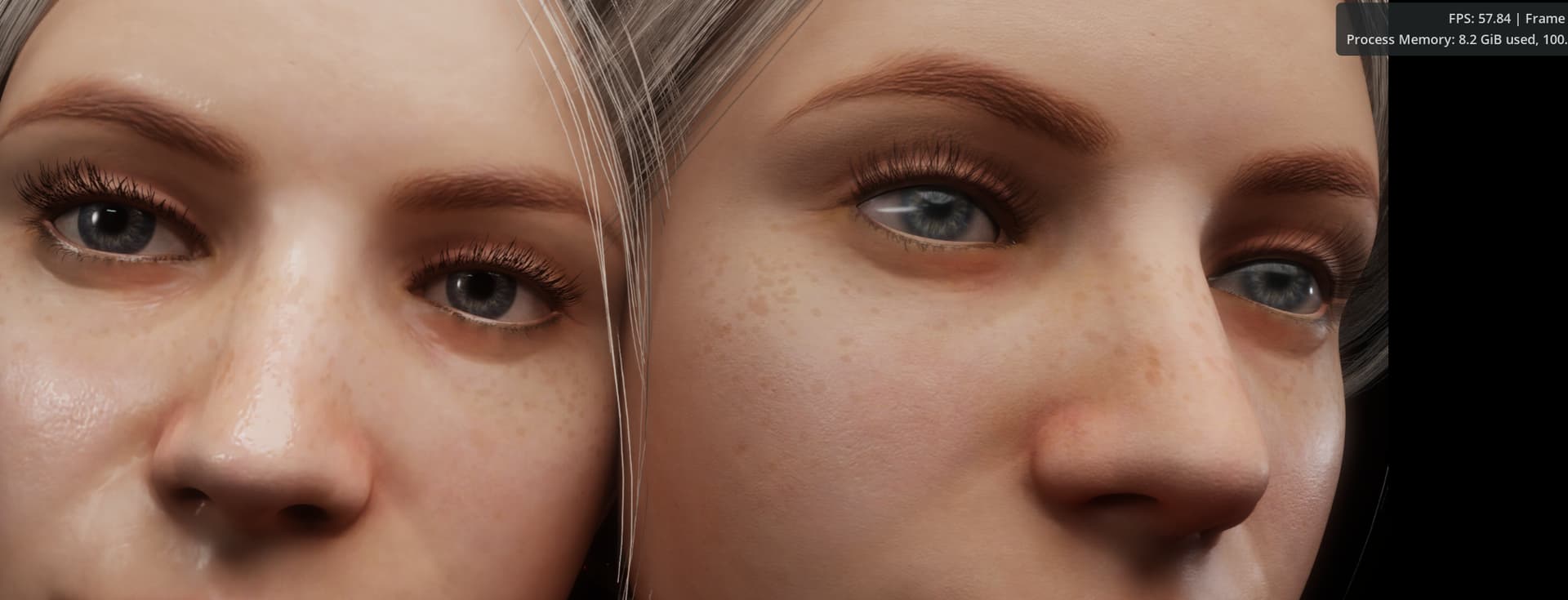

I have the Real Time -optimized version on the left and Path Traced -optimized export on right:
