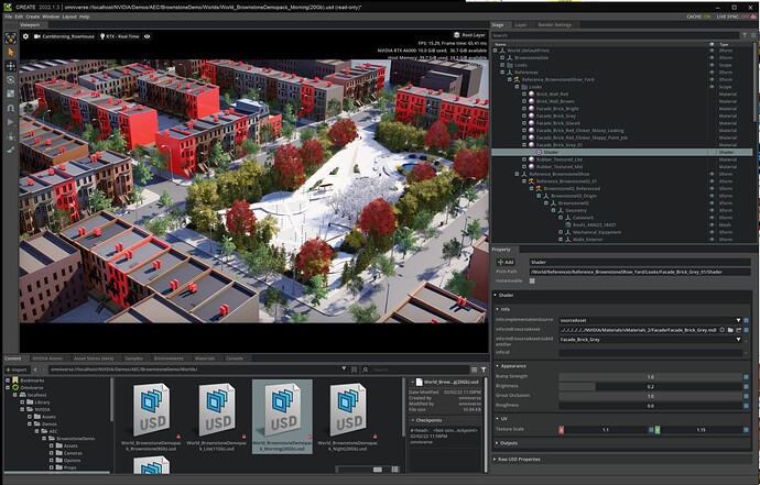

I used the “collect assets” function to download the brownstone demo, but when I open it from my local hard drive, its missing materials:
MIssing ( red ) materials look like:
How to fix fhis? I have nucleus open at my browser…
Pekka

Same thing happens if I open the ( read only ) scene straight from
omniverse://localhost/NVIDIA/Demos/AEC/BrownstoneDemo/Worlds/

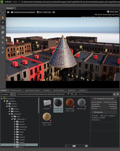

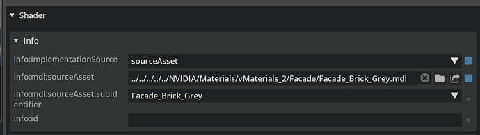

I used nucleus search and found the missing material:
They have re-organized the folders…
Fascade folder is now missing!
But updating all them manually is big work :/
Thank god I can select multiple items and assign them the new material at one click :)
Hi @pekka.varis , thanks for flagging this! It looks like the material path was removed. We will work on adding it back in.
Yep, you can use the “select bound objects” option by right clicking on the material in the stage but you knew that. :)
Thank you, you have fixed this!
It opens now correct again. Also select bound objects was nice tip!
