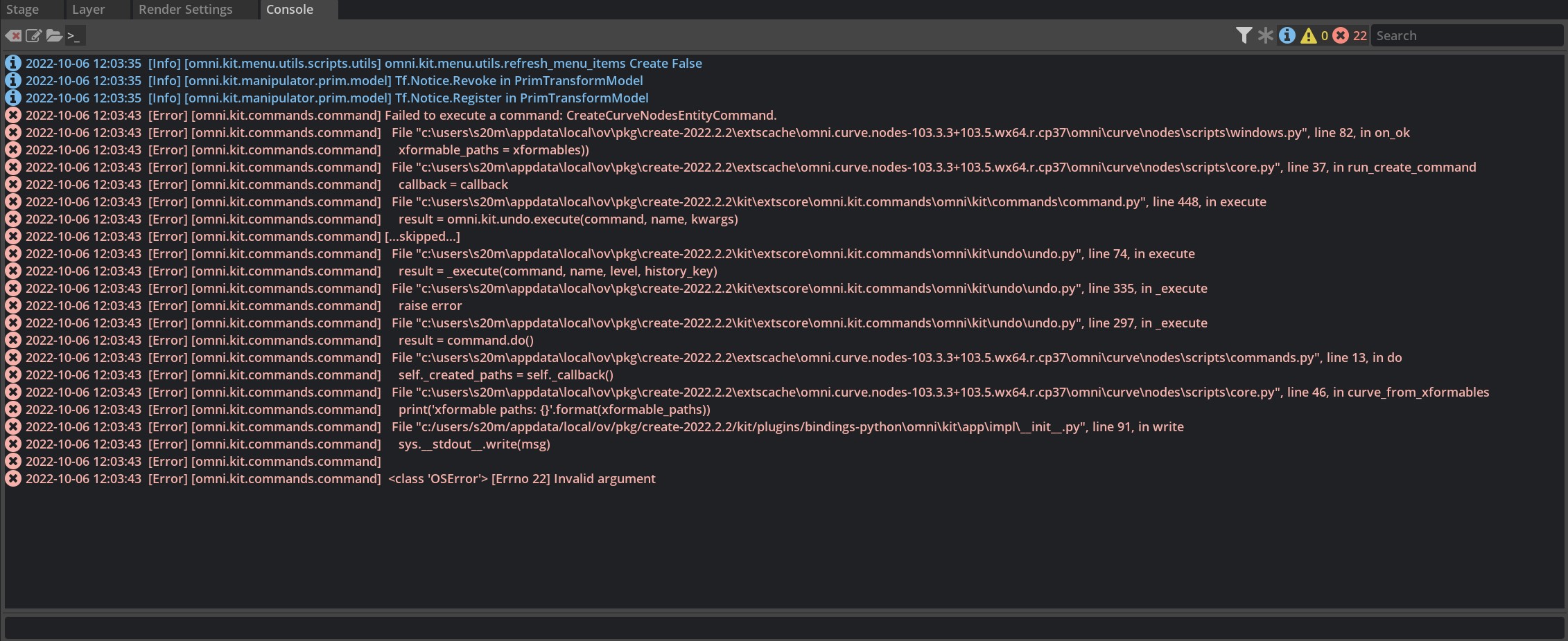

I am following this tutorial https://www.youtube.com/watch?v=7LFu_hJLm6Q for the camera animation along the curve.
When I select multiple xform objects and click Create curve from Xformables I am getting the following error:

Oh, I am on Create build 2022.2.2.
So, how did you fix the error?
Hi, I never got it to work.
Which Create version do you use?
I’m on 2022.2.2, and was able to create a curve.
However camera does not move along the curve, which is weird.
