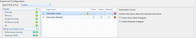

Can't do profiling for Maxwell with CUDA 6 RC?
Has anybody been able to get instruction counts and cycles from Maxwell GPUs?
I’ve tried both Nsight 4, but the performance counters for Maxwell are grayed out:

A most grievous mistake! I was using Visual Profiler from CUDA 5.5 instead of 6.0 !
Now it works, but Nsight still doesn’t. I’m filing a bug.
Were you able so solve the issue somehow?
Yes, I installed Nsight 4.0 RC. Apparently the one from CUDA 6.0 RC was a beta.
