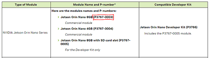

Cant find tegra234-p3768-0000+p3767-0003.dtb
Does anyone know where the tegra234-p3768-0000+p3767-0003.dtb is located. I can only find the tegra234-p3768-0000+p3767-0005.dtb.
I am using the Jetson Orin Nano 8GB (P3767-0003) Commercial module:
After downloading and uncompressing the Linux 36.2 L4T BSP from:
Jetson Linux 36.2 | NVIDIA Developer I am only able to find the device tree blob for the developer kit in Linux_for_Tegra/kernel/dtb but I need the one for the Commercial module, or am I ok just to use the dev kit ones?
Please move to rel-36.3. Rel-36.2 is developer preview and should not be used anymore when GA release is out.
Thank you I have now found it in 36.3
