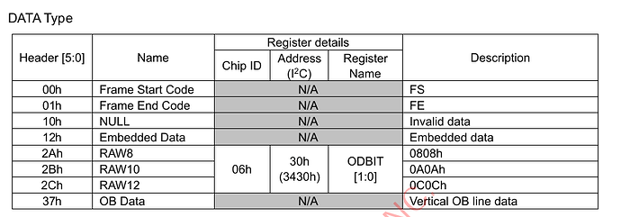

CHANSEL_NOMATCH channel:0x04 error
hello:
I use lane 4, bit10, RGGB format ,in custom camera drivr,I’am on Linux version 35.4.1 GA, error on blow:
root@tegra-ubuntu:/home/yz/nfs# cat /sys/kernel/debug/tracing/trace
# tracer: nop
# entries-in-buffer/entries-written: 476/476   #P:4
#                                _-------=> irqs-off
#                               / _------=> need-resched
#                              | / _-----=> need-resched-lazy
#                              || / _----=> hardirq/softirq
#                              ||| / _---=> preempt-depth
#                              |||| / _--=> preempt-lazy-depth
#                              ||||| / _-=> migrate-disable
#                              |||||| /     delay
#           TASK-PID     CPU#  |||||||  TIMESTAMP  FUNCTION
