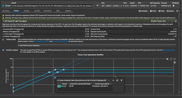

I’m using CuBLAS to do some simple benchmarking on Jetson Thor.
I found that if I’m using FP16 + FP16 acc, CuBLAS would
  1. Select `cutlass3x_sm100_tensorop_h256x256x16gemm_f16_f16_f16_f16_f16_256x256x64_0_ttn_align8_2sm_bias_f16_relu_stream_k` kernel
  2. Achieve ~60 TFLOPs

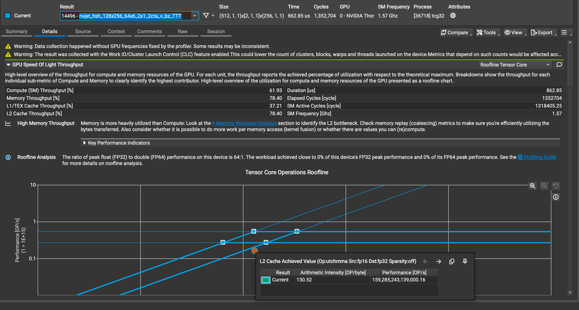

And if I’m using FP16 + FP32 acc, CuBLAS would
  1. Select `nvjet_hsh_128x256_64x6_2x1_2cta_v_bz_TTT` kernel
  2. Achieve ~160 TFLOPs
I searched on the Internet and found that the nvjet kernel seems to be tuned for jetson platform. I’m wondering why it’s not used by CuBLAS if we are using FP16 acc?
Is it only supported for mixed precision inference? Does that suggest us to use mix-precision instead of pure FP16?

Thanks for replying.
Yes, the results are using the same script only changing the cuBLAS option from CUBLAS_COMPUTE_16F to CUBLAS_COMPUTE_32F.
Here’s the script I used

Sure I can use CUTLASS.
But I want to confirm that this is NOT because Thor does worse on single-precision inference than mixed-precision.
What is the configuration you used?
We try the sample code with the default setting but the output is different from yours:
CUBLAS_COMPUTE_32F: 67.36 TFLOP/s
CUBLAS_COMPUTE_16F: 43.77 TFLOP/s
I just fixed the clock frequency to MAXN and used the codes I provided above.
Did you turn out to use CUTLASS kernel or Nvjet kernel? In my case, if nvjet kernel is used, the TFLOPs is much higher.

In your testing, the FP32 acc performance is also better than FP16. Is that expected?
We try to reproduce the nvjet issue internally.
But we are checking the FP16 perf issue with our internal team first.
The issue is fixed in the newer cuBLAS package.
Please try to install the recent CUDA 13.1 release:
Below is the performance we got from the new library:
M=4096 N=4096 K=4096
FP32: 143.31 TFLOP/s
FP16: 167.72 TFLOP/s
M=8192 N=8192 K=8192
FP32: 78.78 TFLOP/s
FP16: 114.64 TFLOP/s
