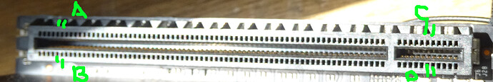

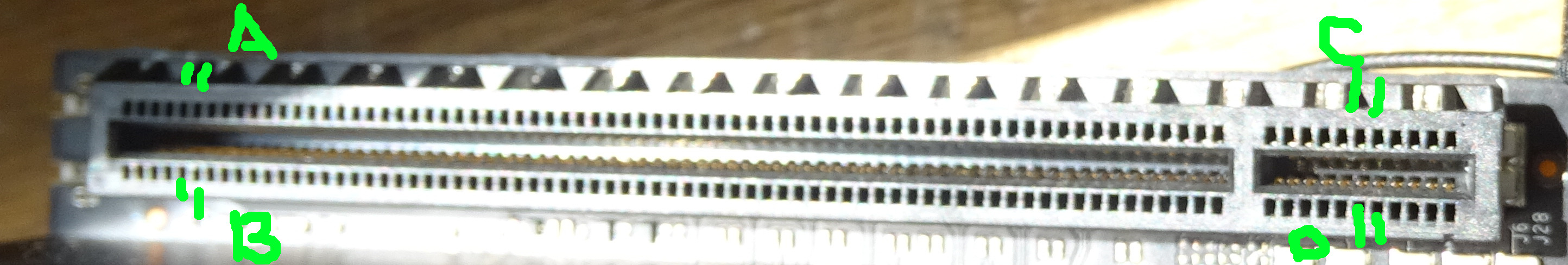

upd. I found J6 is PCI express x16 port, but which of it are the A5/ A6 pins?
Sorry, format typo, and it hides the actual characters.
Corrected.
As to pin, you can download the carrier board schematic and check with hardware engineer.

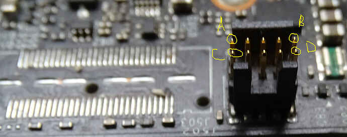

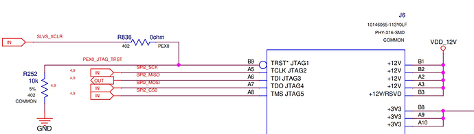

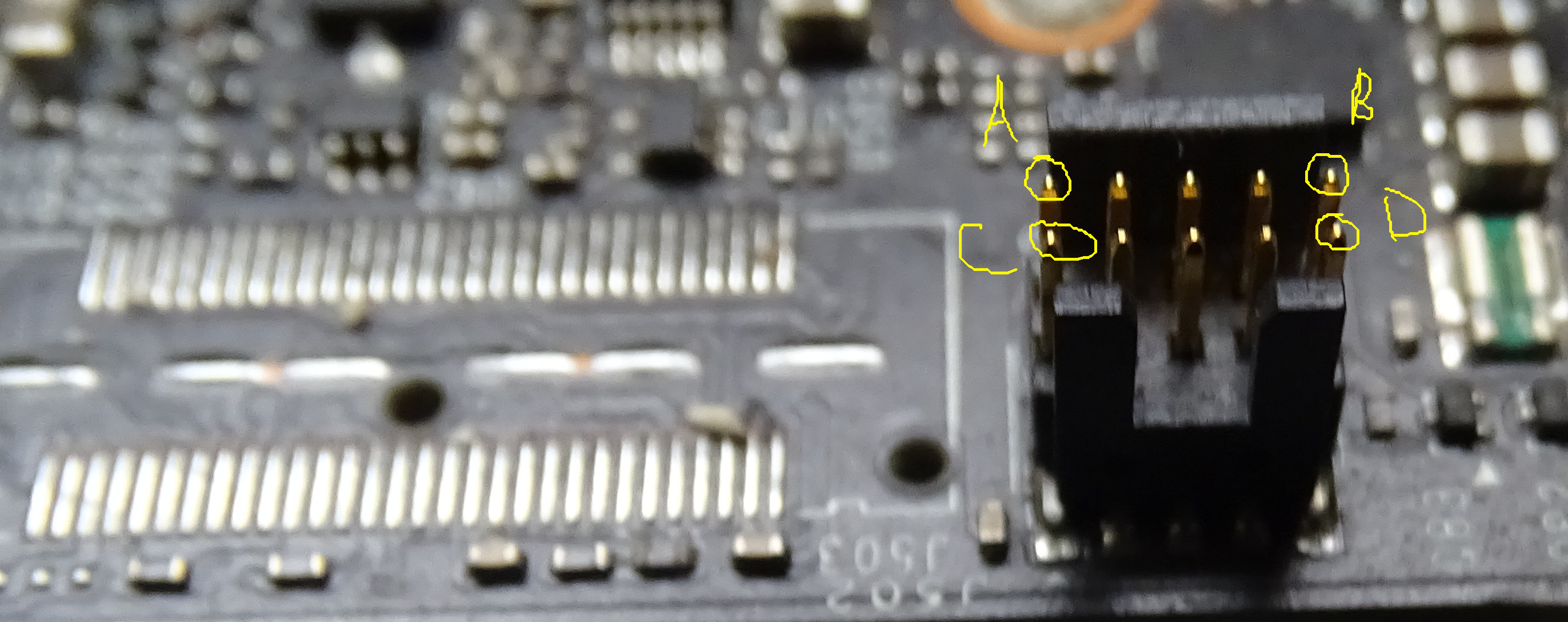

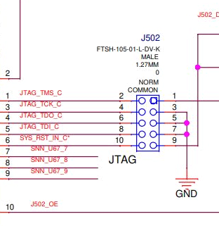

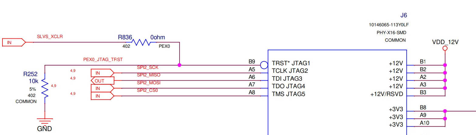

could you confirm if we can access/ shortcut A5,A6 pins via JTAG pinouts?
from Design Schematics it appears that
A5 can be accessed through TCLK JTAG2
A6 can be accessed through TDI JTAG3
@jachen could you clarify, which of A,B,C,D is the pin1 so it would be possible to figure out which are the 2,3 pins to connet, please?

Hello, Andrey:
(Jetson AGX only)
UARTG TX/RX pins are in J6, A5/A6 which are in PCIe x16 slot. They have nothing to do with pins in J502. Please search SPI2_SCK and SPI2_MISO in carrier board schematic.
br
Chenjian
@jachen , Thank you for following up!
(Jetson AGX only)
yes, but you can see from the schematic excerpt attached that J6 header A5 is also labeled TCLK JTAAG2—SPI2_SCK
while J6A6 is labeled JTAG3 TDI—SPI2_MISO
doesn’t it mean that they are connected?
Finally, could you confirm if A,B,C or D are the right A5,A6 pins to shortcut, please?
Hello, Andrey:
You can download the carrier board schematic from Jetson download center.
A5/6 should be near ‘D’ as you marked.
In Jetson_Xavier_Developer_Kit_Carrier_Board_Design_Files_B03, P2822_B03_PCB_assembly_drawing.pdf, that’s near C142.
br
ChenJian
