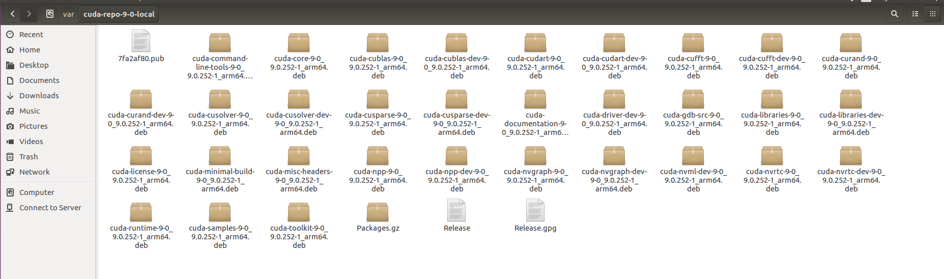

Second, there is a subdirectory of “var” ,the content is list as the attachment.Do you mean I need to install every package by myself.Such as:
dpkg -i cuda-core-9-0_9.0252-1_arm64.deb
Third,
nvcc -v
output nothing but “bash:nvcc:command not found”
At last,as the previous picture shows, wthy it stop witout going on?
So the repo is installed, and you have the possibility of things being correct. There are some cases where the checksum/fingerprint/ID (not sure what to call it with a repo) has some issue and needs to be updated…someone else will probably know more about that.
Normally nvcc will not be in your default path. If you got to “/usr/local/cuda-9.0/bin/”, and then look, probably nvcc is there. You could add this to your path, or you could name nvcc via the full path. Consider that on some systems (mainly a desktop PC) it is possible to have more than one version of CUDA, and thus each has its own directory and there would be no way to have a default path to all of them. Do you have “/usr/local/cuda-9.0/bin/nvcc”?
