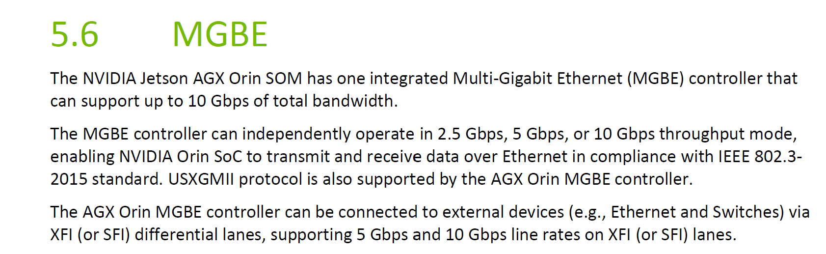

Has anyone created a custom carrier board that had 3 1gbe ethernet ports?
I am brainstorming and thinking of using 3 Aquantia AQR113-B0-C chips and accessing them via the 4 sets of XFI on the jetson agx orin module.
Refer to Jetson AGX Orin Data Sheet. 1x MGBE interface is supported. Log in | NVIDIA Developer
Refer to boards available from ecosystem partners with 3x ethernet. You could use filters to check other options available. Robotics & Edge AI | NVIDIA Jetson
