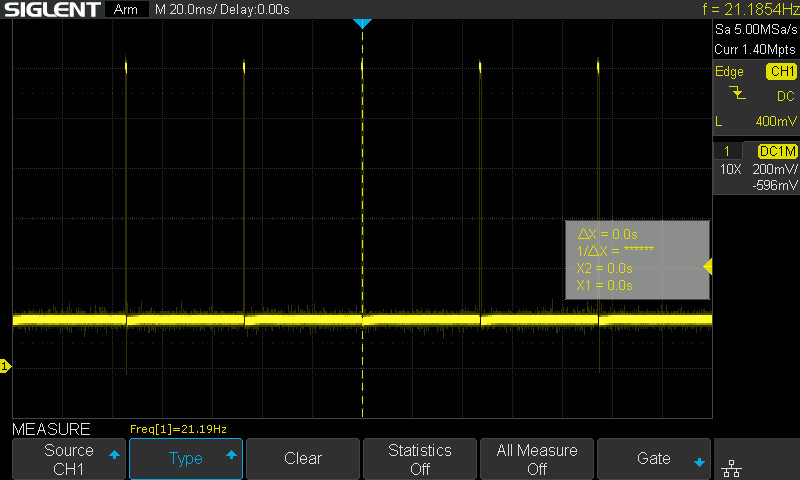

I am implementing a driver for a CSI camera, and I am having issues with all frames I capture containing only zeros when I use the following command:
v4l2-ctl --set-fmt-video=width=1920,height=1080,pixelformat=RG10 --stream-mmap --set-ctrl=bypass_mode=0 --stream-count=3 -d /dev/video0 --stream-to=test_cam_data --verbose
hexdump -C test_cam_data
00000000 00 00 00 00 00 00 00 00 00 00 00 00 00 00 00 00 |…|
00d72b00
I was wondering if this issue may also be related to a discrepancy between the clocks my camera generates, and those expected by the jetson.
When comparing to a Raspberry Pi camera on a scope I notice 1V2 pulses at the frequency of the frame rate. I do not see these pulses on the custom camera. I believe the custom camera just outputs clock continuously, rather than changing to low power mode between frames.
The device tree files have a discontinuous_clk setting. Which in the case of the IMX219 is set to “yes”. Should this be set to “no” in the case where the sensor continuously outputs a clock? and would this be causing my issue?

Have a check the TRM for the REG CSI_CSI_PIXEL_PARSER_A_STATUS_0
It tell the short frame error that mean the sensor output size didn’t as expect.
PPA_SHORT_FRAME: Set when CSI-PPA receives a short frame. This bit gets set even if
CSI_PPA_PAD_FRAME specifies that short frames are to be padded to the correct line length.

The short frame error doesn’t matter with the continuous clocks.
It’s the sensor output less line than the driver report. You can modify the sensor driver or device tree to report less height and active_h in device tree to try.
Thanks for the help Shane, I believe my issues are resolved.
