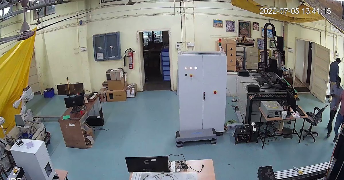

There are two instances in which the ReID fails, one the person is not visible for a long period of time, around 15 seconds and other other only 4 seconds at the most.
I am actually trying to implement a pipeline with a Custom ReID model which I had earlier tested without deepstream.
The ReID works for the same video using the below mentioned repository, where as it fails when I use the same model inside deepstream, ReID also fails when I use the default parameters and the default model recommended by Nvidia.
This is the resultant video using the config file previously uploaded :
This is the resultant video using the custom reid model, which is a engine generated from osnet_x1_0_msmt17 :
The configuration used for the custom reid model :
config_osnet.yml (4.9 KB)
The result from using yolov5_deepsort_reid :
Instance 1 : The person leaves around 22 seconds in the video and comes back at 37
Instance 2 : The person leaves at 50 seconds and comes back at 54
For both instances the yolov5_osnet_reid was able to reidentify the person and assign the id correctly where as reid fails when I run it in a deepstream pipeline

You shared video already have BBox. Can you share the video without BBox?
Original Video without Bbox:
