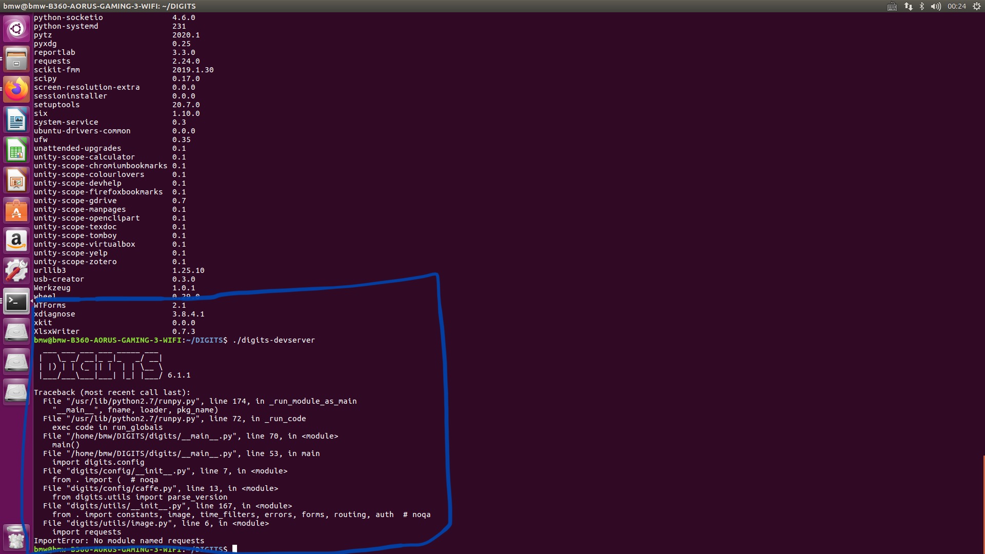

When I use this web(jetson-inference/digits-native.md at master · dusty-nv/jetson-inference · GitHub) to start the DIGITS Server, the error is on the below picture.
It appears “ImportError: No module named requests”. How to solve it?
Hi @andy8902, requests is a Python pip package that is from the DIGITS requirements.txt list:
It should have been installed when you did the sudo pip install -r $DIGITS_ROOT/requirements.txt step. Did you do that, or were there errors?
Note that support for DIGITS in the jetson-inference tutorial is deprecated - it is recommended to migrate to the PyTorch tutorial here: GitHub - dusty-nv/jetson-inference: Hello AI World guide to deploying deep-learning inference networks and deep vision primitives with TensorRT and NVIDIA Jetson.
