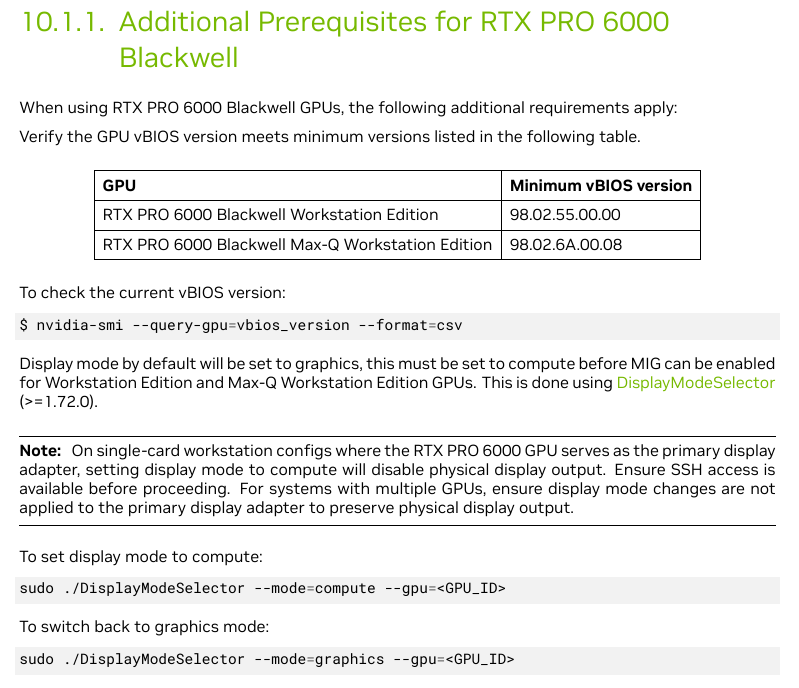

Problem:
The displaymodeselector tool does not yield the same responses as listed in its documentation.
When following the directions to convert to Compute mode “displaymodeselector --mode=compute --gpu=0” does not change the mode. Instead it outputs a list aas if “displaymodeselector --help” had been invoked.
Is there any current documentation for displaymodeselector that shows the correct invocations and responses?
=== system ===
displaymodeslector usage mode: Invoked on Ubuntu server 24.04 with NO graphics drivers installed.
(created just for displaymodeselector)
What driver revision number have you found to work?
How did you get past the displaymodeselector error message about installed graphics?:
$ sudo ./displaymodeselector
terminate called after throwing an instance of ‘std::runtime_error’
what(): In order to avoid the irreparable damage to your graphics
adapter it is necessary to unload the NVIDIA kernel driver first:
I have not personally had to do this, but was just looking at the doc, which on a second look, appears not to be up to date for your card - it’s not mentioned there.
It might be worth contacting one of the posters in this thread.
