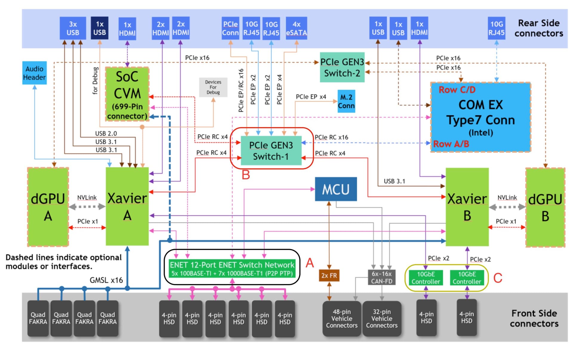

Could general purpose DMA engines in Xavier or Orins be used to schedule a large buffer transfer over PCIe to another Xavier/Orin ? Would this path be more efficient and fast compared to TCP based path taken by DW socket APIs ? Is there an example or sample that illustrates this ?
C2C supports DMA over PCIe and will be available in DRIVE Orin releases. For now you may need to use 10 GbE for large transfers. Sorry for any inconvenience.
Thanks VickNV. For now, on Xaviers dev kit and Pegasus platforms I take it that there is no support for DMA based PCIe transfer functionality.
Can you confirm whether PCIe x4 lane based connectivity for xavier to xavier communication (on Pegasus) is functional at all ? My current understanding is that it is not functional and has not been validated. Please confirm.
Its very confusing. VickNV seem to suggest or ask with the allusion that communication over PCIe, NTB should work. Now SivaRamaKrishnaNV says that 10gbe is the only way to send data across xavier.
Contradiction ?
Yes VickNV we are able to go over path B (of attached pic) with ntb_netdev. However we are not able to get the data transfer rates (we observe 2.2 Gb/s) which seems way below theoretical limit of 4 GB/s for pcie g3 x4. So SivaRamaKrishnaNV I am not sure what to make of “10gbe is the only way to send data across two Xavier” ?
Regarding the DMA access, it is my understanding that Nvidia does not support DMA through PCIe in Xavier to Xavier communications.
That said, I suspect we can use the Linux Kernel’s NTB drivers to gain access to the DMA capabilities of the PCIe port using ntb_transport. Moreover, a quick modinfo suggests that the ntb_transport driver supports DMA (see last line)

I strongly believe that @SivaRamaKrishnaNV means that Nvidia does not provides a specific API + Docs for NTB-based PCIe communication, and that it is up to the engineer to enable and write the software for this type of communication. Is my assumption correct?
