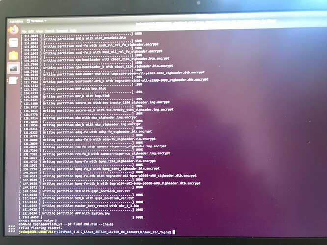

Hello!
I got following error (attached photo) when trying to restore Jetson Xavier NX from the cloned image when using restore command: sudo ./flash.sh -r jetson-xavier-nx-devkit-emmc mmcblk0p1
Clone command looks like this: sudo ./flash.sh -r -k APP -G eMMC_CLONES/backup_20220709_JetsXavierNX.img jetson-xavier-nx-devkit-emmc mmcblk0p1
Unlike the Jetson Nano eMMC experience when (after cloning) I usually get both *.img and *img.raw files very large (and everything works smoothly), after cloning Xavier NX I get *.img file relatively small (119 MB) and *.img.raw is big (13 GB), dunno does it already warns about some problem?
Also: my NX is recognized by SDK Manager as “ordinary” e.g. the production one and NOT as “Developer kit”, anyway I haven’t seen any more suitable target-board parameter than " jetson-xavier-nx-devkit-emmc", am I perhaps mistaken at this step ?
Any ideas? Many thanks in advance…

Basic flash worked!! But of course it resulted with a default image. Is something wrong with my cloning procedure?

I have resolved the problem by another clone-attempt (very same command like before) and then it worked!
After it, this time both *.img and *.img.raw file were large and it was a sign of correct direction!
Thank You very much for Your time!!!
Are you willing to share the command here so that other user can know it?
Yes, there was no change from the “unsuccessful” attempt, command was not to blame, maybe was some problem with copying “system.img”
