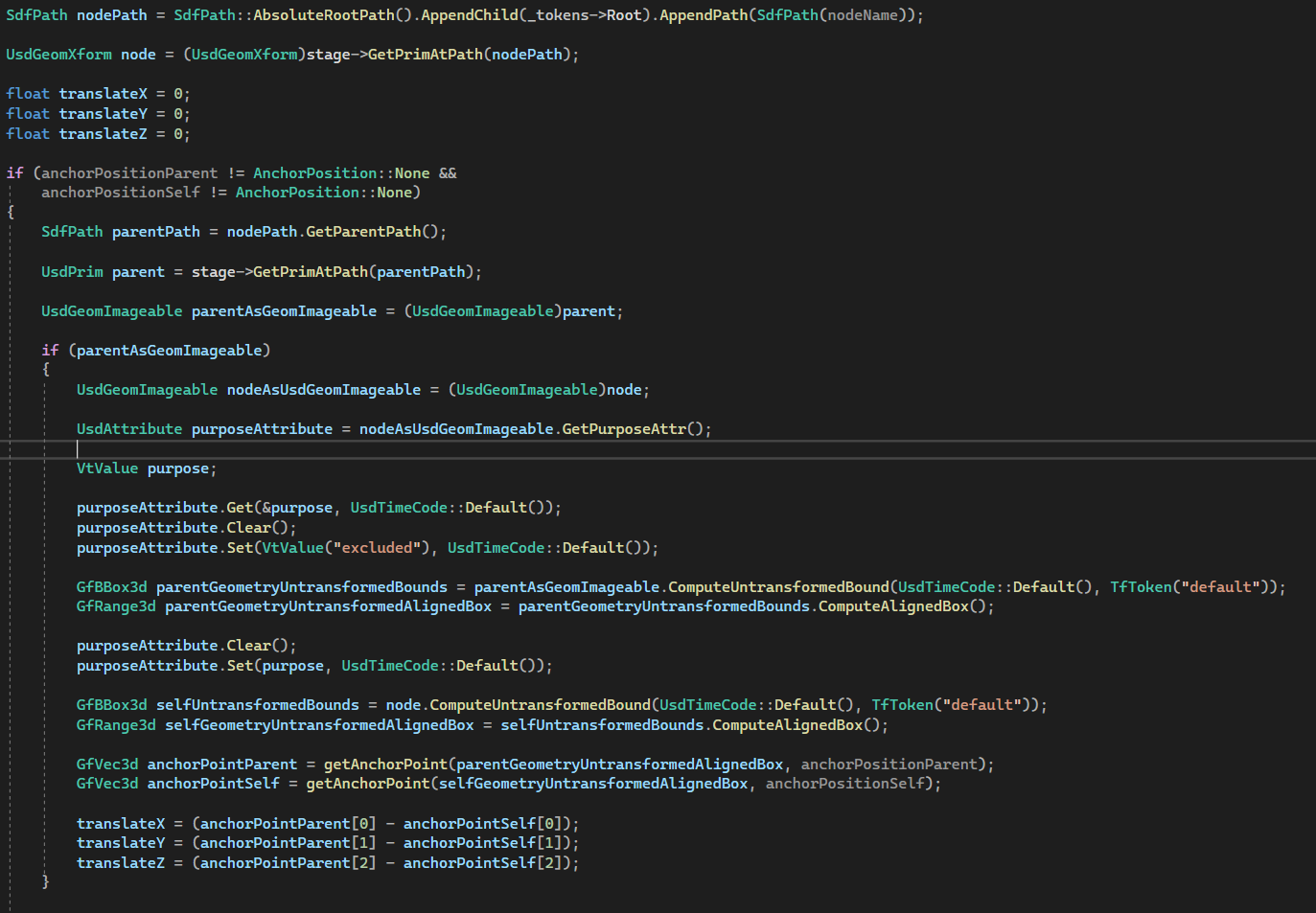

is there a way to explude Node from ComputeUntransformedBound?
We would like to implement a raltive positioning type in our connector, that eanbles us to define something like “Place X right to Y”. Where Y is the parent of X, so we have to calculate the bounding box from Y WITHOUT X.
We have tried SetActive, SetHidden, and MakeInvisible bevore calculating the boundingbox of Y…

thank you for the reply. Those methods are the methods I`m using… here is a sample of our code:
“node” is the node that should be aligned. So we get the parent of “node” and then we would like to calculate the boundingbox of the parent WITHOUT “node”.
In the meantime I found out, that this should be possible through pupose-tokens, that are handed over to the boundingbox-calculation-method. So I tried to override the purpose of “node” to exclude it from the bounding box calculation. but that doesn´t change anything… “node” is still inlcuded in the boundingbox…

I`ve found the problem… purpose does only accept a sceial defined range of values… when I use “guide” it works like expected.
