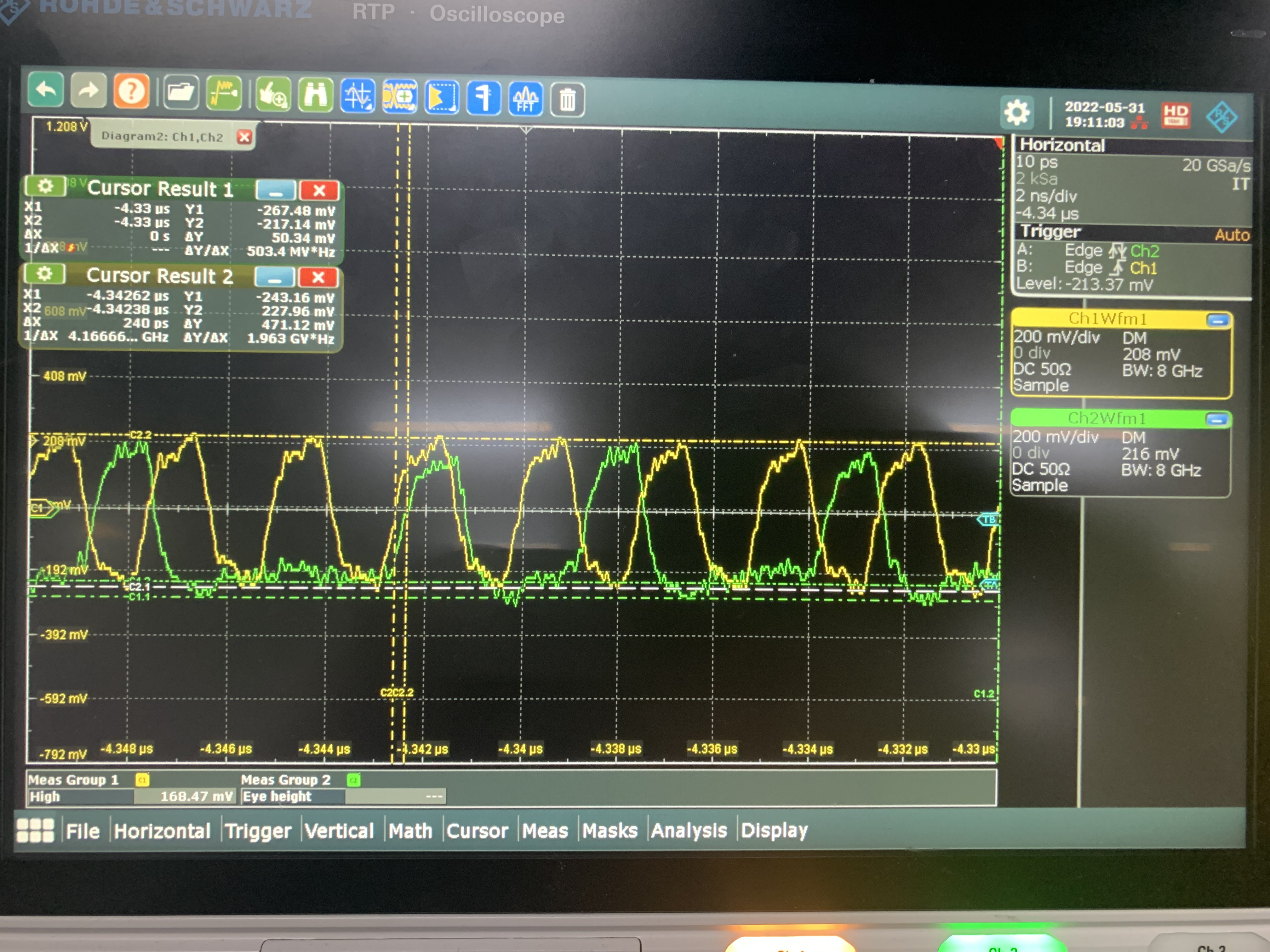

After observation of the waveform on the oscilloscope, it is confirmed that MIPI data is coming from the camera sensor.
The MIPI Clock rate we are getting is around 400 MHz
MIPI Data rate is 800 MHz.
can you please help me what is the possible reason for this error and what is the solution to overcome this?

The trace tell start of transfer multiple bit error that could be the HW signal problem.
May need probe the MIPI signal to make sure match MIPI spec.
Thank you for your quick reply.
please refer attached MIPI Waveform.Can you check once and let us know if it is okay or not
Green Waveform: Data
yellow Waveform: Clock
Please check the timing like this.

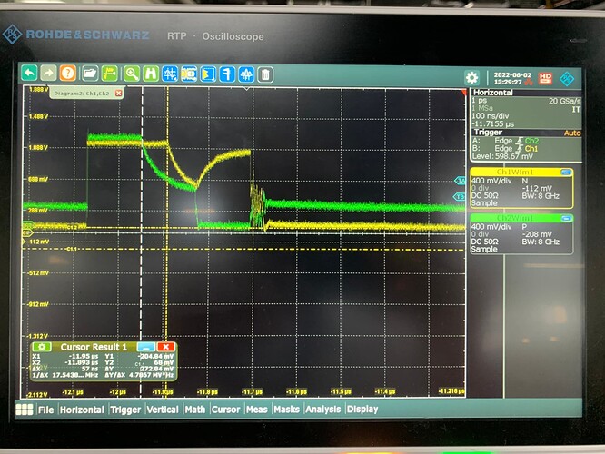

Hi @ShaneCCC
PFA Of required waveform of P and N channel
The signal doesn’t looks like right.
umm not similar to that you shared.
Every time we are getting this waveform only. did you have any idea why this we are getting? I mean does this related to MIPI configuration or some camera register configuration mismatch.

Notes: we’ve also seen mipi waveform in oscilloscope if we are getting this error.
The MIPI output was control by the sensor. Suppose should be able configure by the sensor REG.
Please consult with sensor vendor to confirm the settings.
