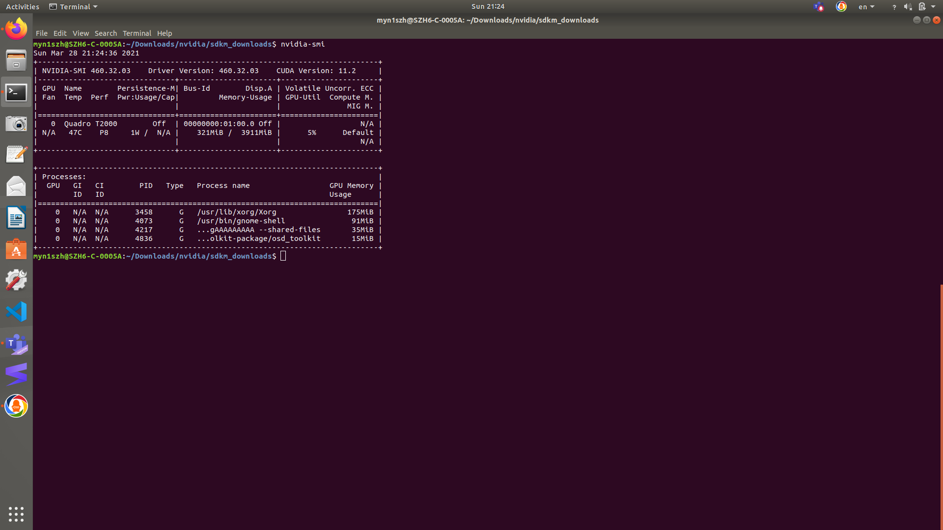

I followed the video guidance from your website(NVIDIA DRIVE AGX Developer Kit - How to set up - YouTube), but always failed to create drive platform targetfs, it seems the docker issue make it failed
The init setting of pegasus board: DriveWorks 2.2
SDKM_logs_DRIVE_Software_10.0_(rev.2)_Linux_for_DRIVE_AGX_Developer_Kit_2021-03-24_22-06-15.zip (3.5 MB)
The sdkmanager failed logs
My host ubuntu 18.04 with GPU:

It looks like apt-get is broken on your system which is causing the issue. Could you please fix the issue with sudo apt-get update before flashing the target or check flashing from another host which has no issue with apt-get.
