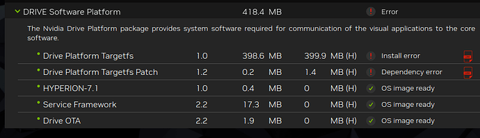

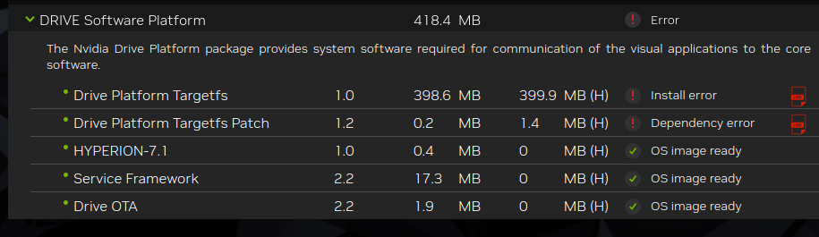

But there is problem for installing Software Drive Platform to Target Rootfilesystem.
So, there is nothing about Drive SW in targetfs.

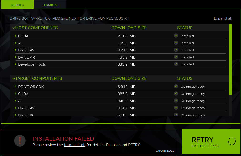

Does that mean you notice issue in Step 3 where it downloads all the needed files to flash and cross compile applications? Could you check the flashing logs to see if any issue with system state. Does sudo apt-get update working? Also, does the host has any other DRIVE OS/CUDA/Driveworks/TensorRT releases installed? Make sure you check using a freshly installed host to avoid system state related issues.
In step 1, you need to select both host and target hardware and continue download all the needed files. once all the files downloaded on host, a pop up expected to come to select flash A+B/A/B to continue flashing. We can skip this option and continue manually flashing using bootburn.
I was able to successfully flash DriveOS using bootburn.sh, and it works well—there are no issues with DriveOS itself.
However, the problem lies with the Drive Software Platform. We need to flash the full package of Drive Software 10.0.
I’m unsure whether it’s possible to install the Drive Software Platform on the AGX Xavier or Pegasus directly, without using a host PC, after DriveOS has been installed.
So, I attempted to include the Drive Software Platform in the root filesystem before installing DriveOS from the host PC.
I reinstalled the host PC following your instructions and tried again, but the same error occurred as before.
SDKM_logs_DRIVE_Software_10.0_(rev._2)_Linux_for_DRIVE_AGX_Pegasus_XT_2025-07-22_17-35-06.zip (2.1 MB)
In this failure stage, there is noting in DriveSW directory in targetfs.
And while investigating, I found something under the DriveSW_Components directory.
I then tried running full_install_setup.sh as shown below, but that attempt also failed.

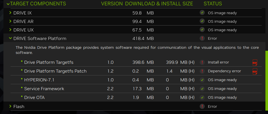

I notice below messages in your NV_DRIVE_PLATFORM_RFS_TARGET_COMP.log
17:45:58.769 - Info: e[92mINFO:targetfstool_5_1_6_x_avrfs:e[0minstalling cuda on targetfs
17:45:58.769 - Info: e[91mERROR:utilities:e[0mCould not find /targetfs/root/apt-repos/binary/cuda-repo-ubuntu1804-*_arm64.deb
17:45:58.769 - Info: e[94mDEBUG:linux.targetfstool_linux:e[0mCleaning up TargetFSTool
Dear @MDS_Eddy ,
I have downloaded sdkmanager 1.9.3 debian and skipped flashing step and noticed below messages in logs . Could you check with sdkmanager 1.9.3 with fresh ubuntu 18.04 host
^[[92mINFO:targetfstool_5_1_6_x_avrfs:^[[0minstalling cuda on targetfs
^[[92mINFO:linux.targetfstool_linux:^[[0mInstalling package /root/apt-repos/binary/cuda-repo-ubuntu1804-10-2-local-10.2.19_1.0-1_arm64.deb
^[[92mINFO:linux.targetfstool_linux:^[[0mRunning command: dpkg --install /root/apt-repos/binary/cuda-repo-ubuntu1804-10-2-local-10.2.19_1.0-1_arm64.deb
^[[94mDEBUG:common:^[[0mSubprocess(es) exited succesfully.
Thank you,
I’ve verified Installation is completed on SDKManager-1.9.3
