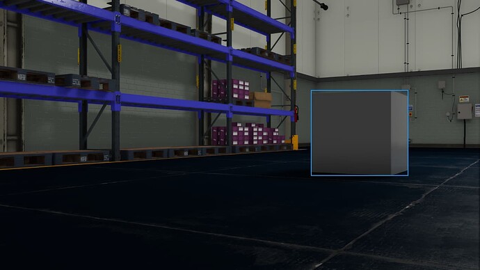

I’m working on generating a custom dataset with labeled pointclouds. As stated in the Range-Sensor API, the get_semantic_data function returns the semantic id of the hit for each beam in uint16.
To test that I build a very easy scene with a LiDAR and a camera inside the warehouse sample environment. The only semantic class is given to a cube. Here is a picture of the scene:
The camera view is as follow, on the right the lidar parameters are visible:
I added a transform component to the cube that changes the x,y and z coordinate. Not the rotation tho. To extract the Information I need I utilize the Python API. I randomize the scene in total 10 times and after each iteration I wait 5 seconds for the scene to fully load. This was stated to might be a problem here. Furthermore I included a time.sleep() as proposed in this forum entry.

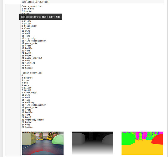

The problem I am facing is that the semantic data that is returned does not entirely match the cube! To show what I mean I plotted the pointcloud, (which looks very promising) and emphasized the specific points that are labeled to be “on the cube” in color yellow.
First of all the bbox2D & semantic groundtruth for scene 1 and 9
BBox-Scene1
Semantic-Scene 1
BBox-Scene 9
Semantic-Scene 9
Everything looks very nice. Now the plotted Pointcloud with emphasized labels in yellow for both scenes:
Pointcloud + labels for class cube in yellow - Scene 1:
Pointcloud + labels for class cube in yellow - Scene 2:

Thanks for reporting this issue, I’ve filed a bug for us to take a closer look at it
I think the problem might be that the lidar has horizontal scans, while the pointcloud has a different set of points. Thus, merging them might bring discrepancies. It might be better to merge the depth map with the semantic.

@jan-oliver still working on error 1, but for error 2, does this notebook reproduce your usecase?
you can run it via ./jupyter_notebook.sh lidar_semantics.ipynb
(the cells to start SimulationApp and create the environment might take a bit of time to run)
lidar_semantics.ipynb (76.5 KB)
I’m seeing the cube and sphere in both the lidar and camera semantics, but there might be something missing from my test.
