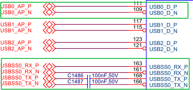

Below is the schematic of the USB port used for flashing on our custom board:

HI,
You should share the schematic of the connector part too.

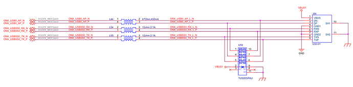

As requested, here is the schematic of the USB connector section that’s used for flashing on our custom board:
We’ve also attached the orin_nano.txt file, which is converted back from the dtb used during flashing.
This includes all relevant USB kernel device tree configuration for our current setup.

Your device tree totally didn’t modify things for usb2-0… please read document.
