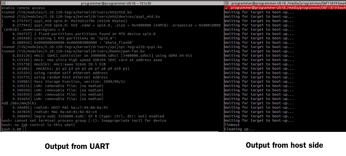

- Jetson Orin Nano Developer Kit (SD card):
sudo ./tools/kernel_flash/l4t_initrd_flash.sh --external-device mmcblk1p1
-c tools/kernel_flash/flash_l4t_external.xml -p “-c bootloader/t186ref/cfg/flash_t234_qspi.xml”
–showlogs --network usb0 jetson-orin-nano-devkit internal
This method fails too:
Waiting for target to boot-up…
Waiting for device to expose ssh …RTNETLINK answers: File exists
Waiting for device to expose ssh …Run command: flash on fc00:1:1:0::2
SSH ready
blockdev: cannot open /dev/mmcblk0boot0: No such file or directory
[ 0]: l4t_flash_from_kernel: Starting to create gpt for emmc
Active index file is /mnt/internal/flash.idx
Number of lines is 58
max_index=57
[ 4]: l4t_flash_from_kernel: Successfully create gpt for emmc
[ 4]: l4t_flash_from_kernel: Starting to create gpt for external device
Active index file is /mnt/external/flash.idx
Number of lines is 17
max_index=16
writing item=1, 9:0:primary_gpt, 512, 19968, gpt_primary_9_0.bin, 16896, fixed--0, fe748843591648f5359fec568f4b4e2450b4c36f
Writing primary_gpt partition with gpt_primary_9_0.bin
Offset is not aligned to K Bytes, no optimization is applied
dd if=/mnt/external/gpt_primary_9_0.bin of=/dev/mmcblk1 bs=1 skip=0 seek=512 count=16896
16896+0 records in
16896+0 records out
16896 bytes (17 kB, 16 KiB) copied, 0.0577961 s, 292 kB/s
Writing primary_gpt partition done
Error: Invalid argument during seek for read on /dev/mmcblk1
[ 18]: l4t_flash_from_kernel: Error: partprobe failed. This indicates that:
- the xml indicates the gpt is larger than the device storage
- the xml might be invalid
- the device might have a problem.
Please make correction.
Flash failure
Cleaning up…
