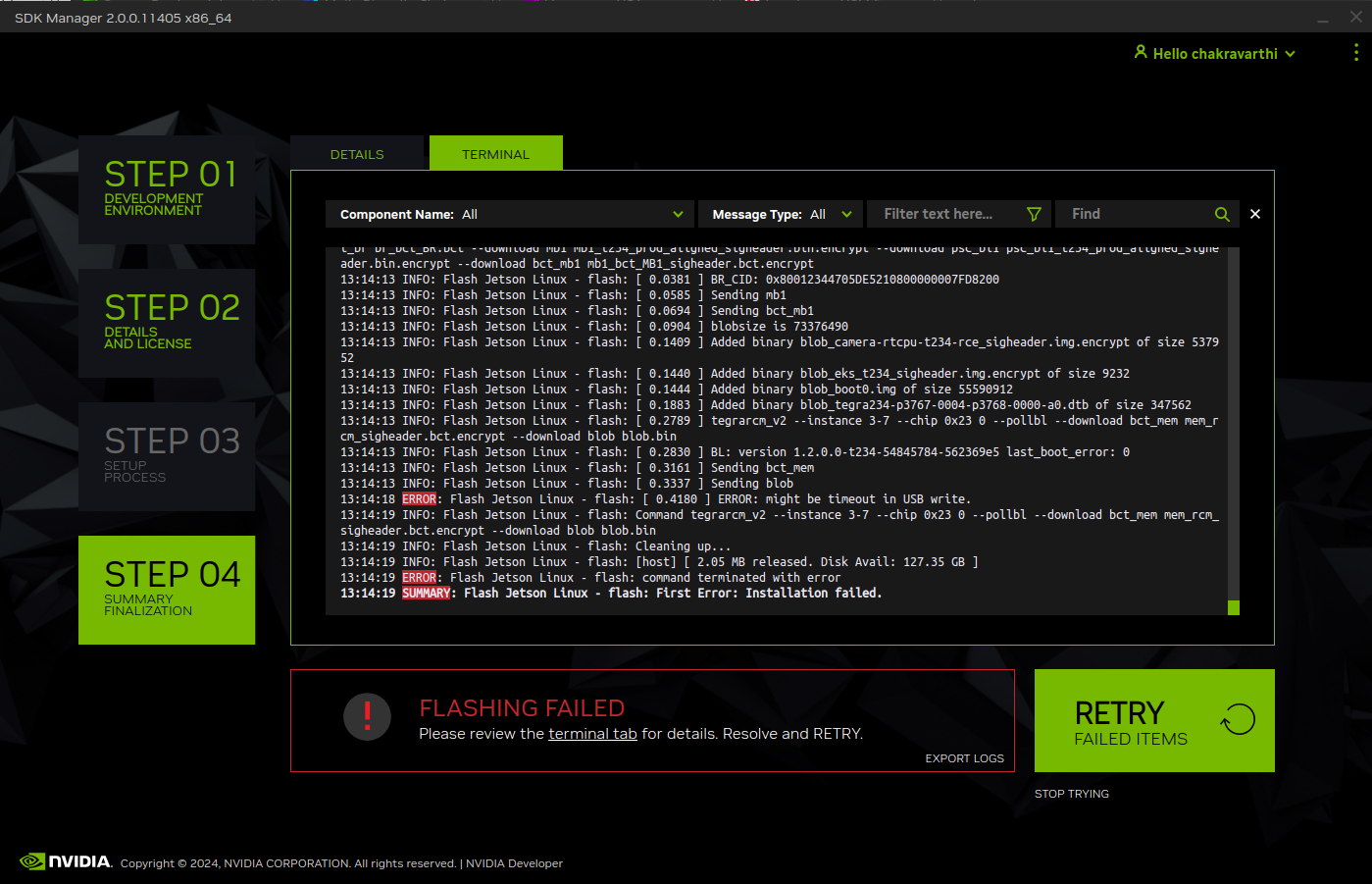

We flashed orin nano 4gb fresh som using jetson orin nano developer kit with Default JP5.1.2.We hit the bellow error.
[   8.9259 ] ERROR: might be timeout in USB write.
Error: Return value 3
Then we tried the steps mentioned in the following thread USB timeout error during flash Orin. How to resolve that still the behavior is same.
Then we tried with jetson orin nano developer kit with NVIDIA SDK managet(Both JP5.1.2 and JP5.1.3) still the flash fails. Im attaching flash logs of both custom board and Devkit. Please help me to resolve this issue

Please attach the full sdkmanager zip file after one flash.
Your sdkm log currently has multiple flash logs inside one file.

Could you try 5.1.3 and share the logs? Want to prevent it is new module with PCN update case.

Want to prevent it is new module with PCN update case. what it means ?
We will update the components inside the module periodically. Mostly the DRAM.
In brief, the module produced in 2024 may not work with the software released in 2023.
Please always share the sdkmanager host side log and uart log together.
They are all paired. You should not share sdkmanager only sometimes and uart log only in another time. You should share them altogether and make sure they are from the same flash attempt.

FYI , Initially we have 50 fresh orin nano soms out of 50 we flashed 48 soms successfully with JP5.1.2 without any issues . only two soms have problem it seems.

Hi @WayneWWW, could you please provide an update on this? If it’s the SOM problem, we will proceed with filling out an RMA as well."
Hi, Please RMA this module.
