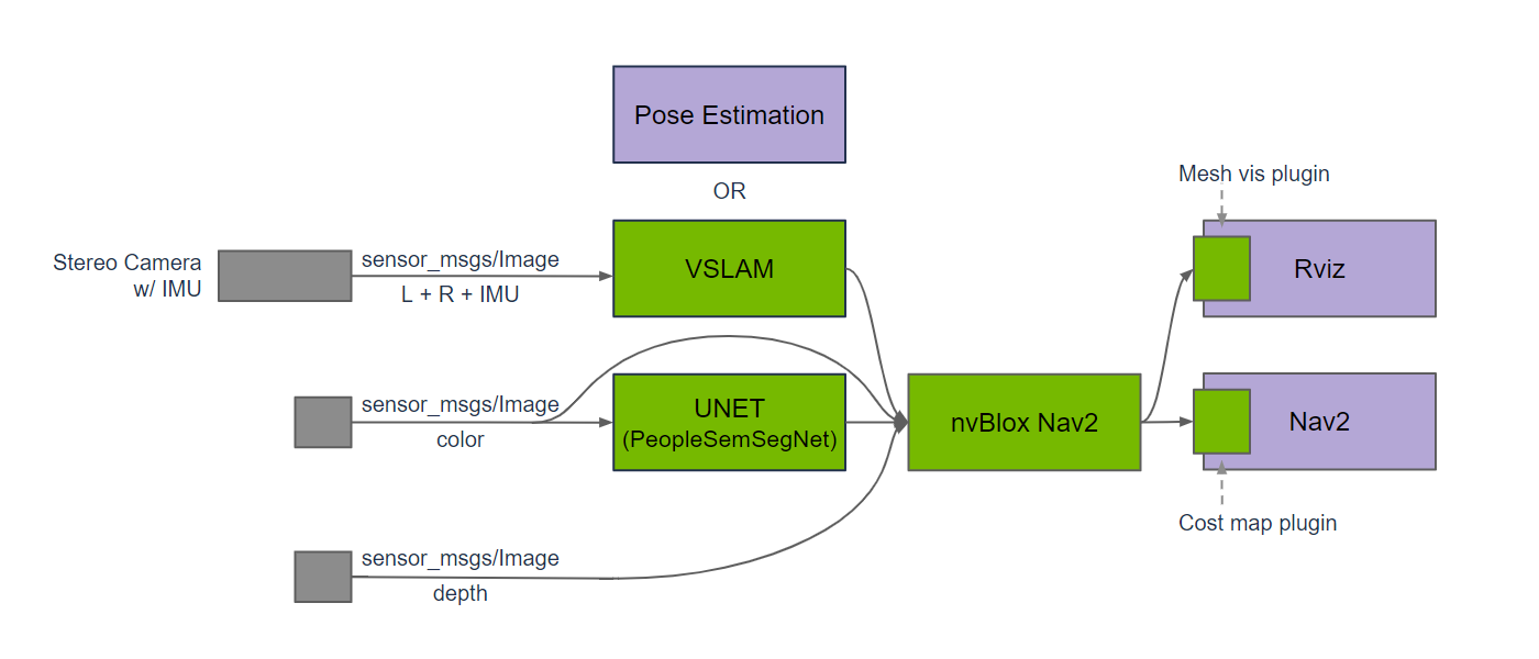

The best way is running Isaac ROS vlsam and Isaac ROS nvblox to localize and map the environment, building a pipeline this way:
How effective is a single camera and the mentioned lidar and wheel odometry? Can a reliable operation be achieved with these, or are there additional required cameras or sensors?
Isaac ROS vslam uses only the input coming from a stereo camera and IMU (optional) and doesn’t work with a single camera, lidar or wheel odometry, but you can use this data with a Kalman filter and use this output such an input for Isaac ROS nvblox and recontruct a 3D scene.

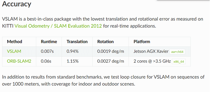

Also, there’s a value related to accuracy. Are the Translation and Rotation errors mentioned here instantaneous error values, and if so, is there any data related to the accumulated error when a vehicle returns to its starting position after being navigated?
What is the difference in accuracy between using and not using an IMU, and is there a measurement for this? Or is this difference significant?

You can find all evaluation metrics on the KITTI benchmark can be found on IsaacElbrusSLAM

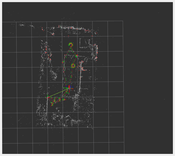

Thank you @aozkilic for the excellent questions regarding navigating with vslam/nvblox. I too am struggling to grasp how a saved vslam map relates with or works with an nvblox saved map. In the end, I’d like to build an autonomous AMR and give users of the AMR a map to set navigation points. I have what I believe is a successful vslam map of my space that I included below, but like you, am not sure what metric to use to confirm the space is completely “slammed”.
I am also able to use the action LoadMapAndLocalize to successfully get localized on the map above. Unfortunately, I am not able to run vslam and nvblox at the same time, as my Jetson Orin Nano simply runs out of memory (also have a zedx camera). Were I to be running something beefier though, I presume my next step would be to obtain an nvblox map of the same space previously vslam’d. @Raffaello does the above sound correct to you? And if so, which of the nvblox map saving actions would be the right one for generating a 2d cost map? I don’t mean to hijack your thread @aozkilic, but sounds like we’re struggling with the same things.

Although the IMU improves accuracy, it can only help for a brief period of time when the video input is of poor quality, and tracking could fail.
