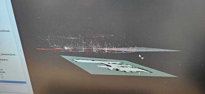

I’m working on a robotics project where I’m integrating NVBlox with vSLAM (using isaac_ros_visual_slam) and robot_localization to improve pose estimation. The main goal is to compensate for odometry drift in the NVBlox-generated map.
Everything launches and runs as expected, and the map initially builds correctly. However, over time, significant drift occurs—particularly an unstable map→odom transform—which causes the entire map to rotate or shift independently of the robot’s actual motion. I also tried using only the robot’s odometry, but the issue persisted. Additionally, I tested with two different RealSense cameras, the D435i and the D455, one at a time.
I am using the NVIDIA container on a Jetson AGX Orin. I started by running the RealSense + NVBlox example from the official repository, but I experienced some drift in the map. Because of this, I would like to fuse visual odometry with the robot’s odometry to improve accuracy.
I’ve attached my launch and config files below.
Thanks in advance for your help!

Hello
I don’t have an answer to your question, but I want to know where did you get the D435 camera from? is there available online USD file?
I am facing this same issue, were you able to find a solution?
