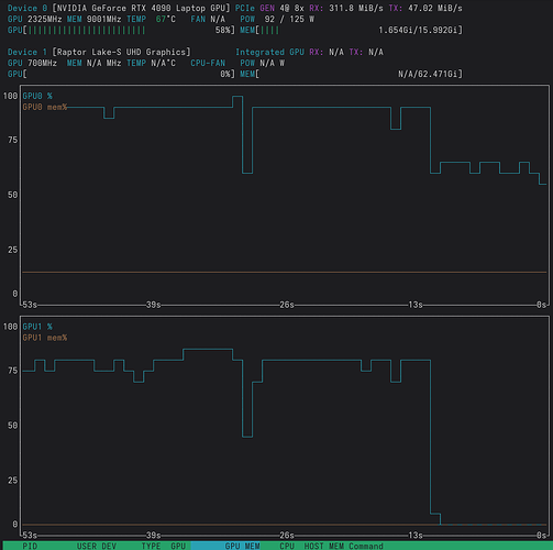

== Some evidence pictures of the game launched and the nvtop ==
Solved: not a driver issue.
The blurry/low-quality look was caused by the in-game Gameplay Resolution Scale, which was set to 28% (Settings → Graphics → Display). The game was rendering the 3D scene at roughly 717×448 and stretching it to 2560×1600, so the UI was sharp but the world looked smeared.
Fix:
  • Resolution: the panel’s native resolution (2560×1600 on this laptop; check with cat /sys/class/drm/card*-eDP-*/modes | head -1)
  • Gameplay Resolution Scale: 100%
  • Click Save
On Windows the game picked correct defaults by itself. Under Proton on this hybrid-graphics laptop (Intel iGPU + RTX 4090), the first-launch auto-detection chose 28% and saved it to the config. Posting in case anyone else runs into the same thing.
