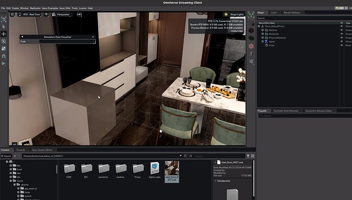

I run the Isaac Sim in a docker container and use Streaming Client to connect it.
The strange thing is that when I loaded 4 tasks and 10 tasks, the memory usage remained unchanged, but the visual interface became laggy and Fps dropped. What is the reason?
And I cannot use more than 3GB although 20GB available.

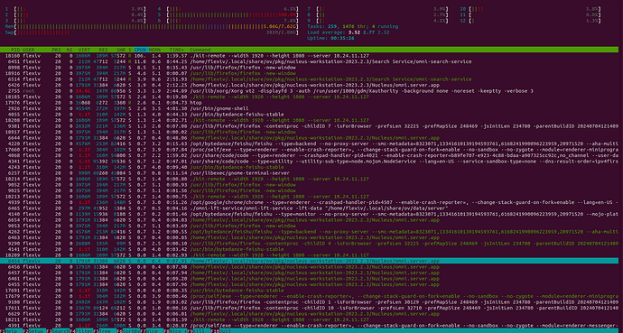

I think you are hitting your CPU limit, not your GPU limit. I am assuming these assets are animated or at least physics based simulations. That is all on the CPU as well. So you could really load 100 of these robots and if they are instanced, it will not increase your GPU load or strain, but if they are animated, each one will drain the CPU more and more. If you disabled physics and animation, you may find this runs super fast.
Plus you are running in a docker AND streaming. Very laggy.

I check the usage of CPU by htop, and the screenshot is as follows.
