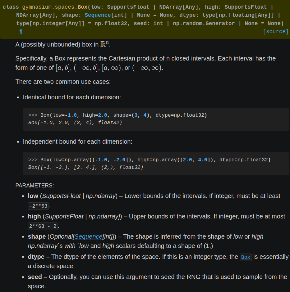

  1. action_space = gym.spaces.Box(low=np.array([-0.1, -0.1, -0.1]),
    high=np.array([0.1, 0.1, 0.1]))
    observation_space = gym.spaces.Box(low=np.array([-1, -1, -1, -1, -np.inf, -np.inf, -np.inf]),
    high=np.array([1, 1, 1, 1, np.inf, np.inf, np.inf]))
  2. run source/standalone/workflows/sb3/train.py
Error Messages
omegaconf.errors.UnsupportedValueType: Value ‘Float32DType’ is not a supported primitive type
Screenshots or Videos
Additional Information
The documentation of stable baselines3 shows np.float32 is the default type of the gymnasium.spaces.Box. There could be a contradicting statement between Isaac Lab and Stable Baselines3
Hi @zhizhuo0928
This is a hydra/omegaconf (argument) limitation described in [Question How to set bounds to my action and observation spaces and also change its type? · isaac-sim/IsaacLab · Discussion #1264 · GitHub.
However, that isssue was resolved a month ago.
Are you using latest Isaac Lab version?
