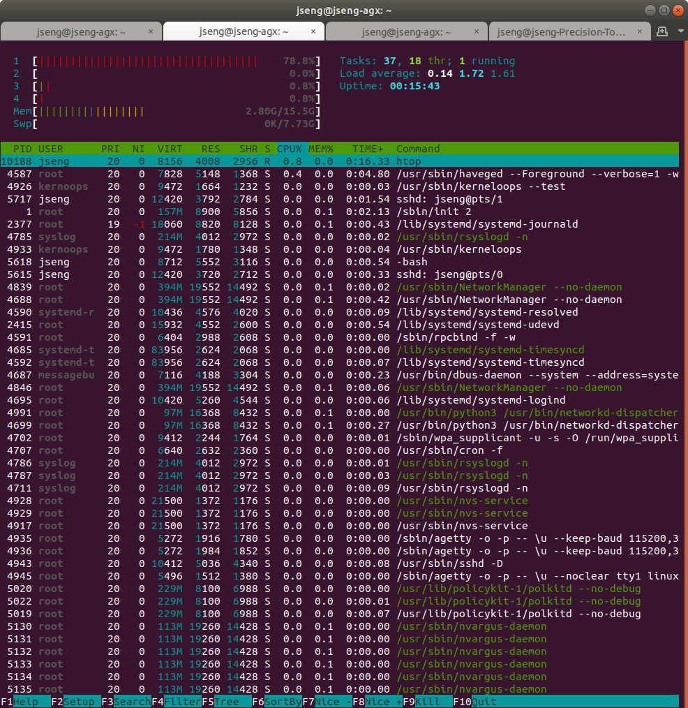

2.Also, sharing the result of htop (probably screenshot) when device is idle may help.

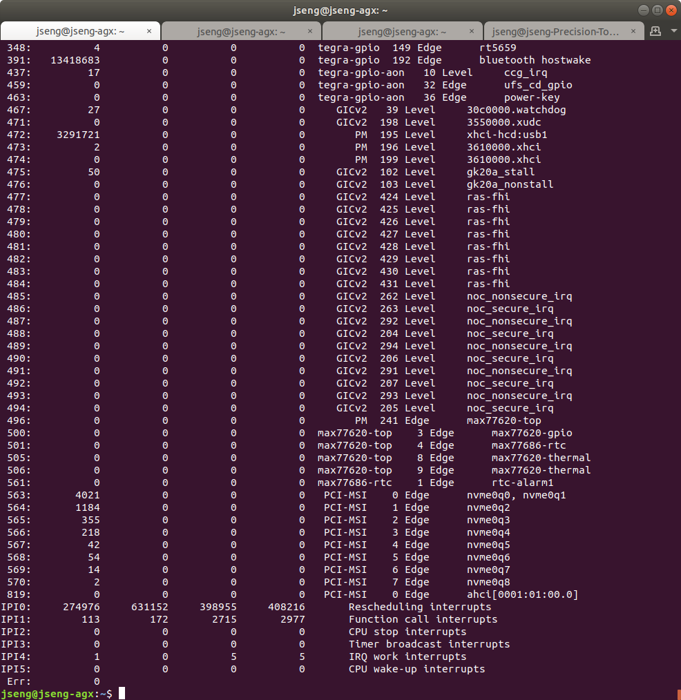

Here are the screenshots (I hope they are readable). I took the screenshots when there was nothing running (heatsink is warm though). As I let the system idle, the value that goes up quickly in /proc/ interrupts is this line:
391: 54836312 0 0 0 tegra-gpio 192 Edge bluetooth hostwake
This seems an issue that happens to many forum user. I would suggest you to use rmmod command to remove bluedroid_pm kernel module at this moment.
