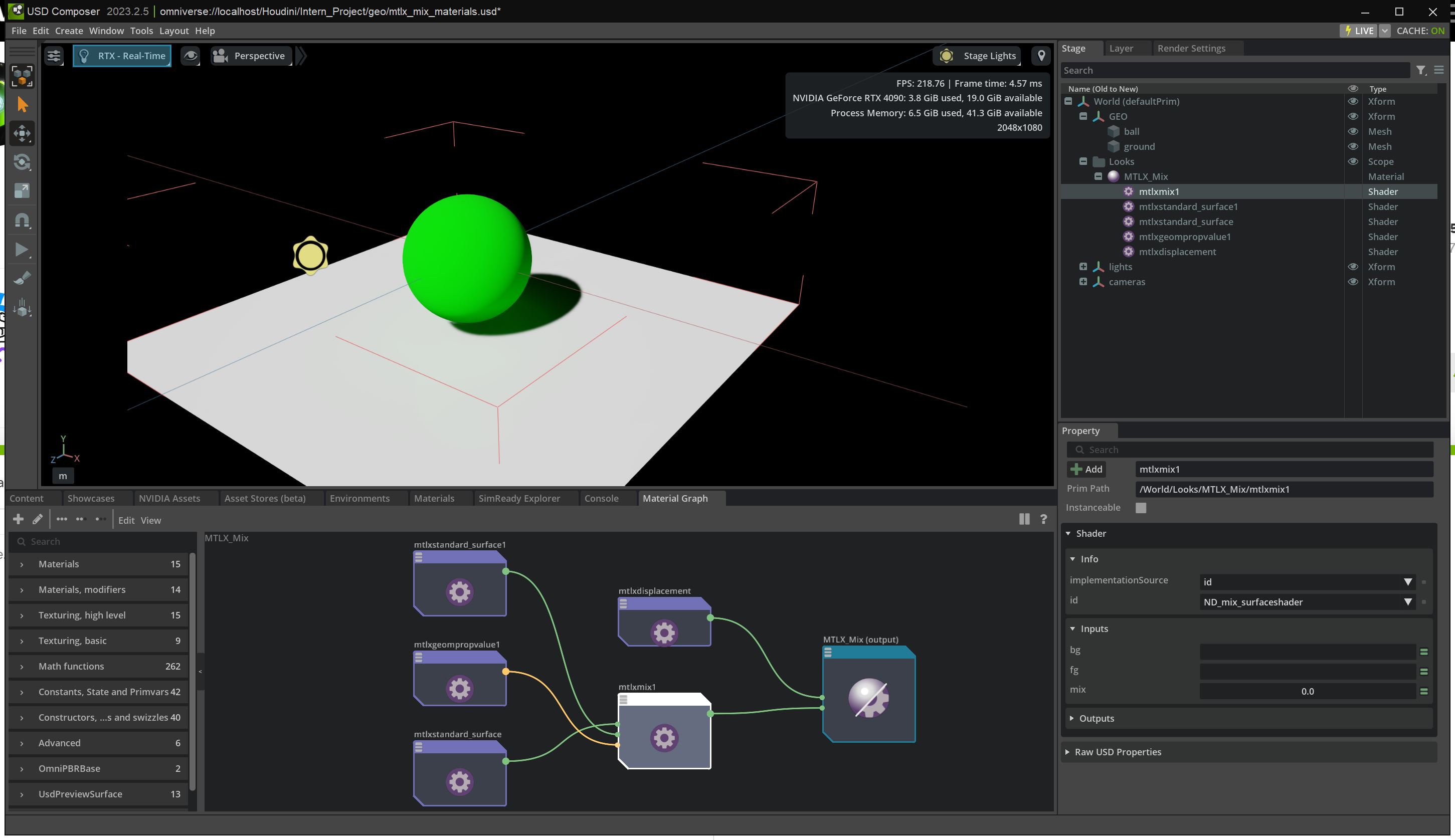

I created a mask on my model in Houdini, and when I export it to Omniverse in USD format, the texture shows incorrectly. It turns out that my mask doesn’t work.
I used this mask to apply different textures, and when I check in Omniverse, I found that the mask was also exported to the USD file.
However, my material in Omniverse can’t read this mask, so the texture doesn’t change.
Can you help me solve this issue? Thank you very much. T.T

When I checked this problem, I found something that might help. I used the [mtlxgeompropvalue] node to read ‘mask’, but it failed. However, when I removed this node and just used [mtlxmix] to control the two textures directly, it worked.
To make it easier to observe, I first created two shaders: one red and the other blue. I set the mix parameter to 0.5, and the model turned purple. When exported to Omniverse, the result was correct. You can even find and adjust the mix parameter in the material’s property panel.
However, when I returned to the file that uses the [mtlxgeompropvalue] node, I found that the mix parameter had disappeared.
What’s strange is that the mix node can be found in the material graph, but it doesn’t work.
Is it possible that Omniverse doesn’t support adjusting nodes like [mtlxgeompropvalue] or [mtlxgeomcolor] in Houdini yet?

You did not specify in your original post what Kit and Graph Extension you’re using, but MaterialX authoring is not publicly supported yet in Omniverse. Is the graph that you show https://global.discourse-cdn.com/nvidia/original/4X/9/5/3/9532fdb42ad8734e4c4620e89c9f4aac5f9c36b5.jpeg, just what’s imported from Houdini? We have complete authoring available internally and it will be available to the public sometime early this year.
If you can, it would be helpful to attach a zip with your USD and any associated texture data for us to inspect what’s going on. However I can say we do support ND_geomprop_<*type> lookups. I’m not sure how ND_geomcolor_color3 works with your indexing without looking at your scene data.

Another thing the team pointed out is that the mtlmix node you have looks like it’s for mixing floats. Not surface shaders. There’s a different ND_mix_surfaceshader node for that.

I didn’t use any Kit. I’m just using USD Composer, and the Graph Extension I’m working with is the MDL Material Graph in Composer.

This graph displays the same nodes as those in Houdini’s Material Library.

In ‘just_mix’, I didn’t use geomvalue and the mix can be adjusted in property panel, however the other one can’t.

I think what we were asking it what version of USD Composer. Maybe you are using an old version. Are you using 2023.2.5 from the Launcher? If so that would be old. The new version is 106.5 from our GitHub Page. GitHub - NVIDIA-Omniverse/kit-app-template: Omniverse Kit App Template
I created a quick demo file that shows the use of the geomprop node to look up a float value called “mask”

Right… so that is really old now. Please update.
