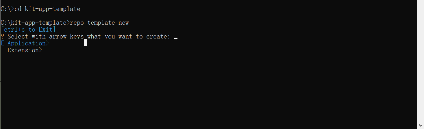

Sorry for my late reply, I went to my internship this afternoon. When I ran ‘repo template new’, my command console displayed like this:
I don’t know what to choose and I can’t type ‘repo build’. T.T
Can you read the instructions please.
GitHub - NVIDIA-Omniverse/kit-app-template: Omniverse Kit App Template
You want to build Composer, so choose Application. Then choose the second one, Composer. But please read and understand the instructions first.
