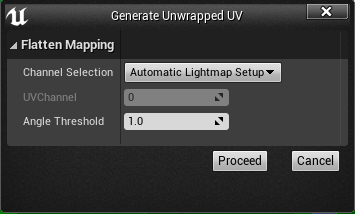

I would like to modify the UV of the StaticMesh component of the Omniverse USD via Python Code in UE4.
I simply need to
Unwrap UV with an Angle Threshold of 1.0
Apply a material
