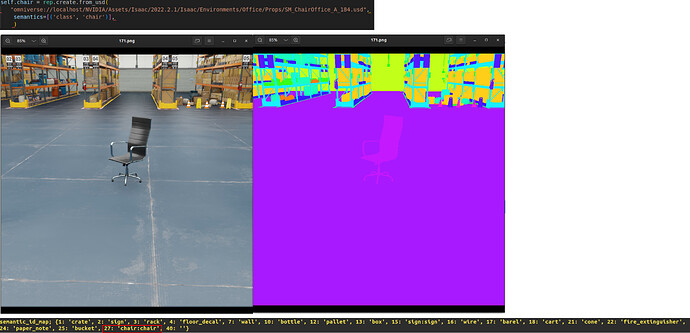

I am using the replicator code in the link below to generate the composite image.
I have two questions.
1.How is labeling of assets in the warehouse space conducted?
When creating the full_warehouse.usd file, are labels already applied? Alternatively, is labeling carried out through some method, such as using a code or function based on the asset’s name?
USD file in use:
“omniverse://localhost/NVIDIA/Assets/Isaac/2022.2.1/Isaac/Environments/Simple_Warehouse/full_warehouse.usd”

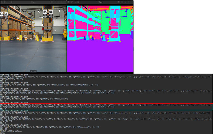

2.When manually adding assets and assigning labels, how are IDs allocated?
When labeling the “chair” asset using rep.create.from_usd(), it receives the ID 27. What code determines the assignment of these IDs?

The id’s are randomly assigned at runtime and are not persistent. You can use idToLabels for example from semantic_segmentation (or other) annotators to get the mapping:
