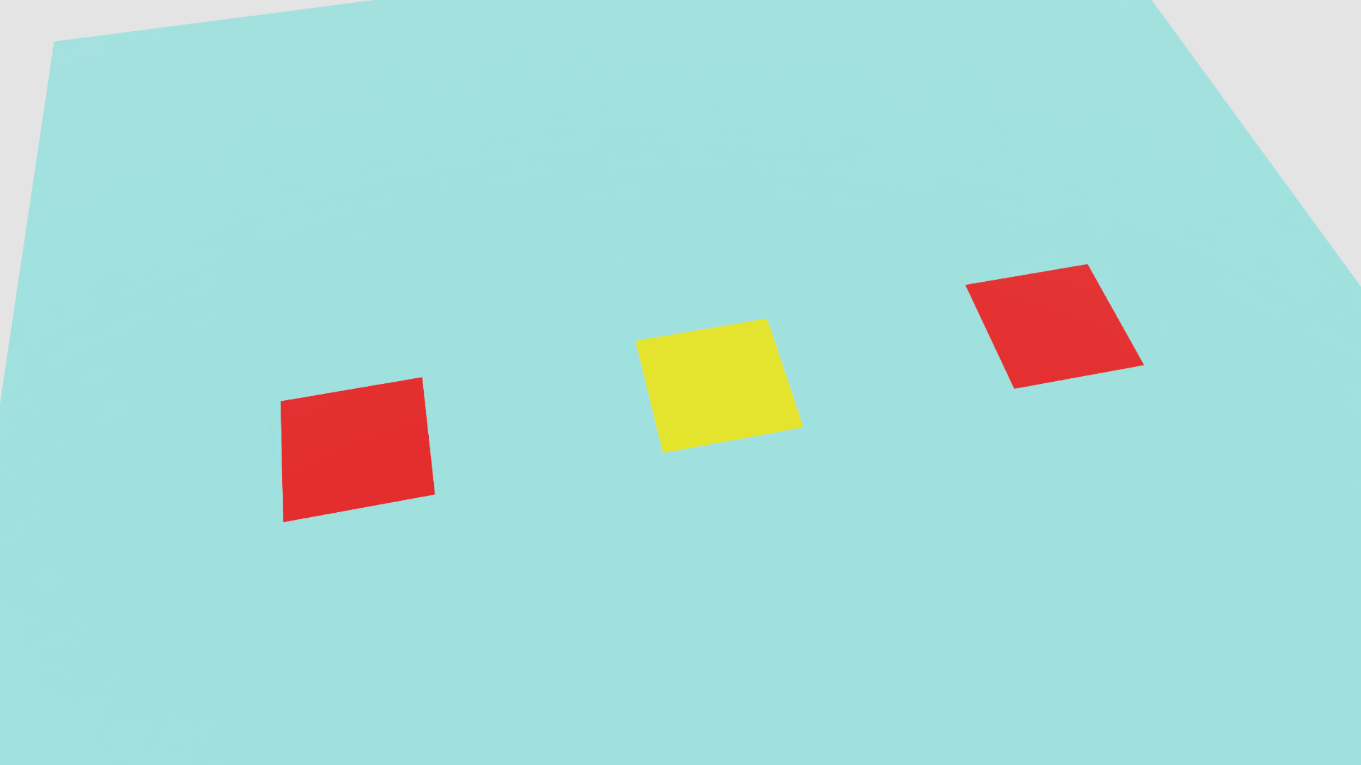

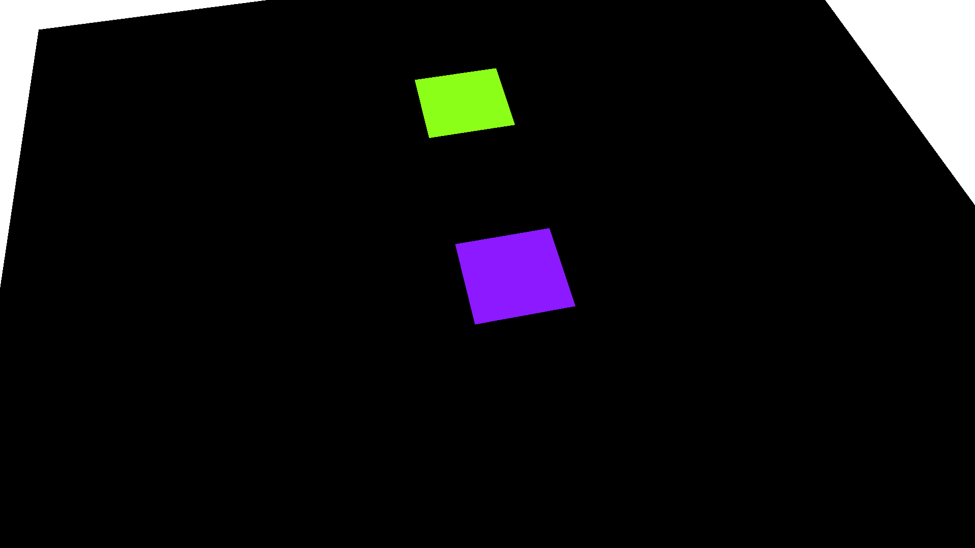

Sample Stage:
  • There are 3 red planes meshes under a parent prim with semantic label “TYPE0_RED”
  • There is a folder with externals USD files with a yellow plane that will be added to the stage under a parent prim with semantic label “TYPE1_YELLOW”
Tested environment:
  • Windows 10 (KIT 107.3.1) and Ubuntu 22.04 (107.3.0)
  • omni.replicator.core extension
  • Using RTX - Real-Time 2.0 render
Expected output: (For example found in samples 0000, 0003, …)
Current output with mismatching label colors: (Example 0001, 0005, 0007, …)
