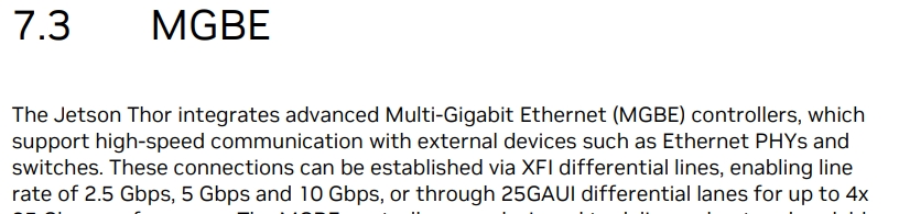

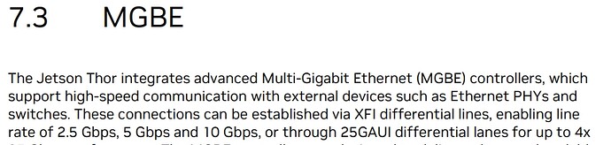

Thanks sgursal. And I have a another question. Can I seperate the 4XFI lane to four SFP+ , every SFP+ support 10G rate? The four SFP+ connectors directily design in the custom borad but not throught the QSFP28 to tranform.
4x MGBE can be configured as either 4x 25Gbps or 4x 10G/5G/2.5G.
Option1: 4x 25GbE
Option2: 4x Mixed 10G/5G/2.5G
Refer to Jetson Thor Design Guide. Snippet below.
