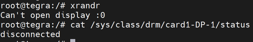

Hi NVIDIA team,
I need to determine whether the monitor is connected through software. After plugging in the monitor, the Ubuntu desktop can be displayed, but xrandr shows “Can’t open display :0”. Additionally, cat /sys/class/drm/card1-DP-1/status returns “disconnected”. when the monitor is plugged in, there is no output in dmesg .
device: Jetson AGX Orin 64GB Developer kit
Jetson: 36.4
jetpack: jp6.1
Thank you in advance!

Let’s go back to the very basic case first.
Please reboot your device. Do not modprobe nvidia-drm driver there. Use the terminal on your Ubuntu GUI and run xrandr again and please do not run it as root.
The problem with xrandr is that I used the root user.

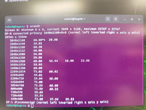

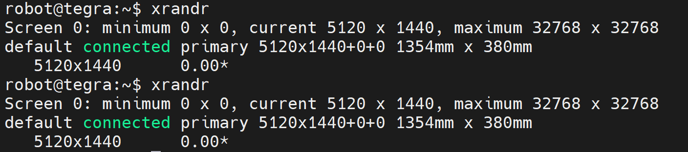

I executed xrandr via SSH.the outputs of xrandr before and after plugging/unplugging are exactly the same, as if there’s no way to distinguish whether the monitor is connected or not.
Here are the results of running xrandr from the GUI command line.
Please do not use ssh to check your xrandr. That one seems having Xforward that it reads the monitor info from some remote devices.
Please modprobe nvidia_drm now and check if you have /sys/devices/platform/13800000.display/drm/card1.
If it is there, then please disable GDM3/Xorg and then run the udevadm command I shared in previous one again and hotplug your monitor cable.
