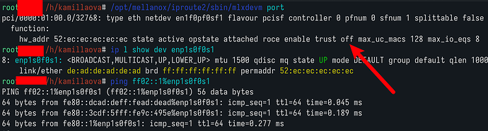

There is no trust parameter in devlink, even in the manpage you provided. However, a closer analysis of the mlnx-ofed-kernel-dkms source code shows that the trust parameter is supported by mlxdevm netlink. But mlxdevm netlink is supported only in mlnx-ofed-kernel-dkms, and vDPA is not supported when it is installed.
I think this is not a fatal problem, solvable by backporting mlxdevm to the upstream mlx5 driver, but it is quite unpleasant. And I do not find any mentions (on linux mailing lists) of adding such parameters (max_uc_macs, trust) from mlxdevm to devlink, have you [Nvidia] thought about it?

I read the source code of the mlx5_esw_set_hca_trusted function used by mlxdevm netlink, and I think the answer is “no”. Because it, unlike the ip-link spoofchkoption (in mainline), sets a trust level register rather than adding a generic filter.

Also, it seems that setting trust off is only supported if the esw manager is ECPF of the DPU, but when I removed the mlx5_core_is_ecpf(esw->dev) check from the driver, that field is actually set to off, but I can’t test right now if it works correctly, and in general I don’t like such “magic”.
Especially since it’s a downstream driver with its own magic things, many of which should be upstreamed - just like the trust field in devlink-port(8).
@spruitt any comments on that?
Okay I tested it and it doesn’t works.
