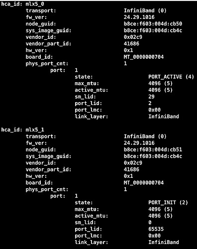

One of my BlueField DPU’s port in is PORT_ACTIVE, which is normal. However, the other is always in PORT_INIT state, even after I ran /etc/init.d/opensmd restart. When I check opensmd status, it says ‘active(running)’, sounds normal, so how can I fix this problem? Please help me😢
My DPU OS is ubuntu 20.04, ofed version is MLNX_OFED_LINUX-5.2-1.0.4
For some reason, I can’t physically touch the machine myself right now. But I’ll keep your suggestion in mind and check the HCA connection when I get a chance.
