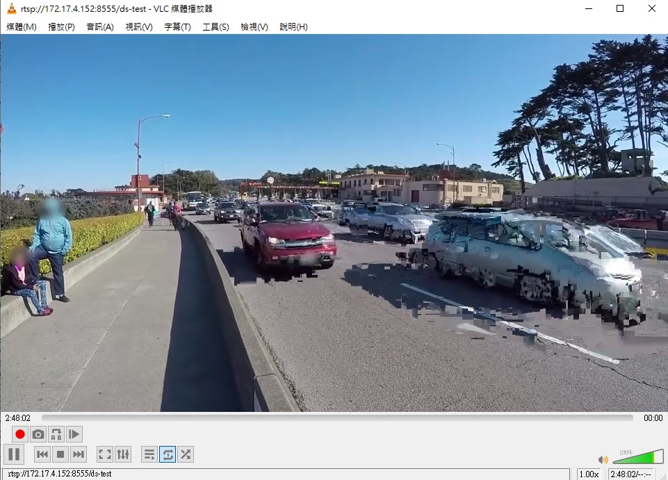

I have one another question. If there are 8 input stream, are there 8 RTSP stream output ?
From the VLC, we only see 4 RTSP stream output.

Can you refer this config file to enable multiple RTSP output?
You can playback the output RTSP with below command line:
$ gst-play-1.0 rtsp://localhost:8555/ds-test --videosink=“nv3dsink sync=false”
$ gst-play-1.0 rtsp://localhost:8556/ds-test --videosink=“nv3dsink sync=false”
ds-config-0_agx.yaml (4.1 KB)
With your ds-config-0_agx.yaml , only this link rtsp://localhost:8555/ds-test is valid, the other rtsp://localhost:8556/ds-test is not valid.

  1. I can play multi-rtsp videos by ports, but it has lags. Is it my network issue ?
  2. The video stream outputs have no any bonding box. How to add it ?
  3. How to modify for 8 channels ?
