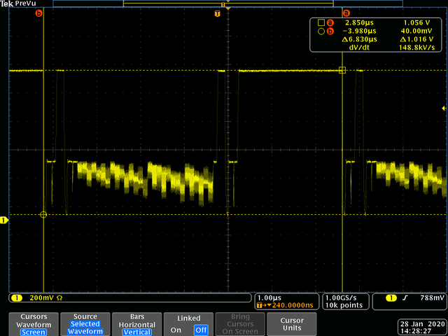

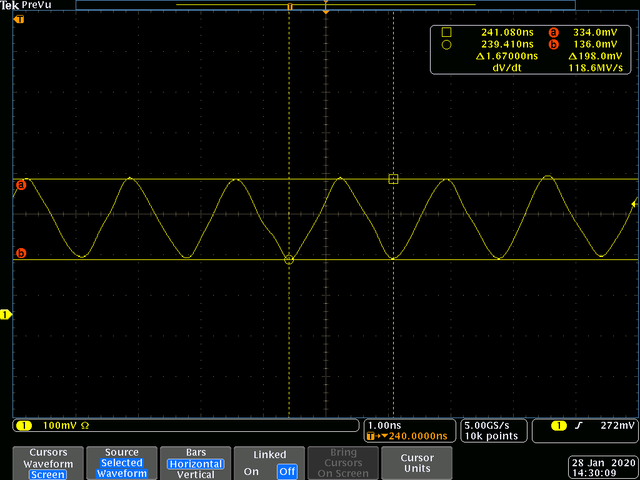

UPDATE [2020/01/28 16:10 CET]
I’ve achieved to get another error. Watching with the oscilloscope, all the signals were looking OK but one, which was not good due tho a physical defect. We fixed that, and now the error is giving more information:

The signals look like this:
Data signals:
Clock signal:
