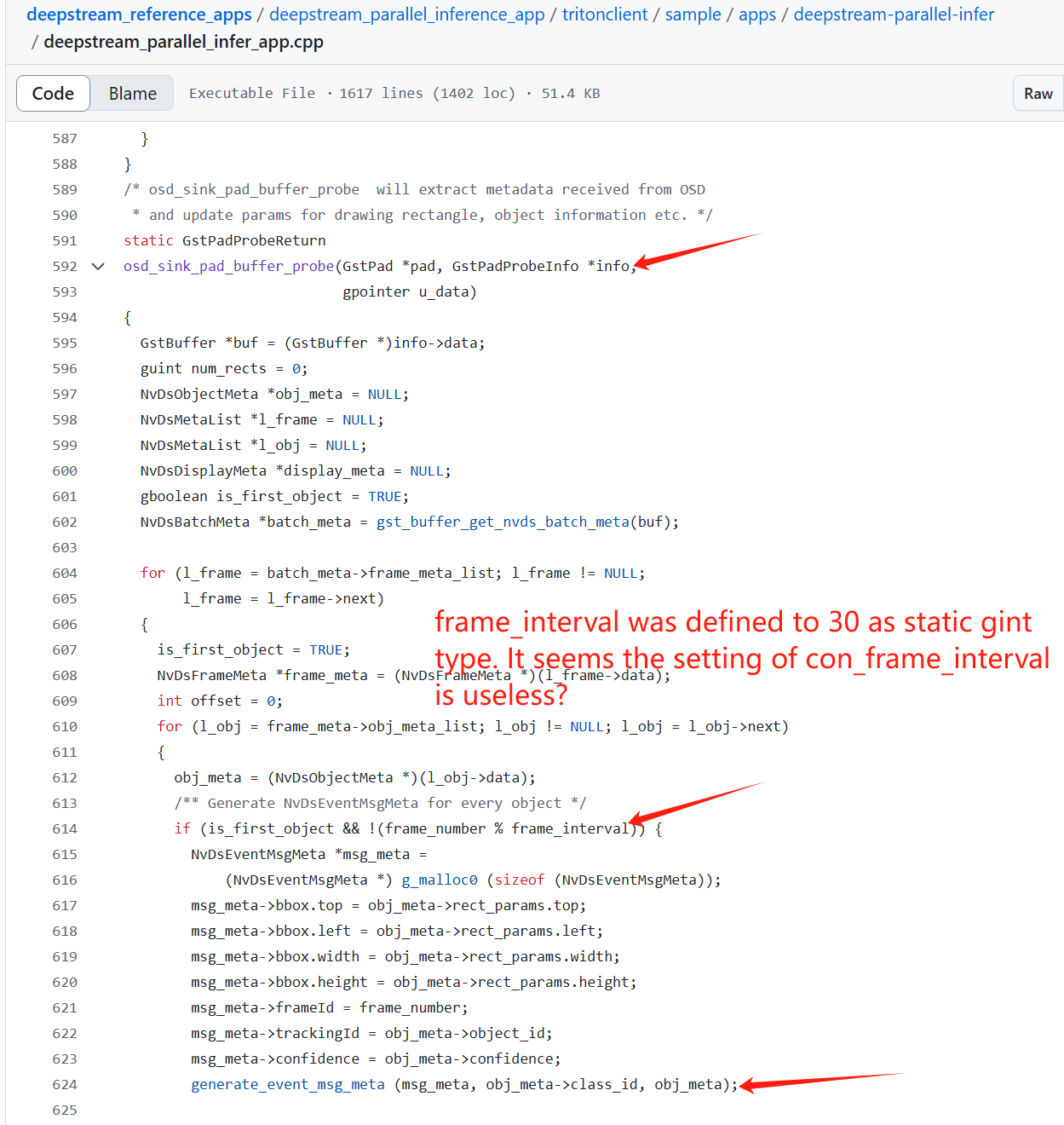

1 . For the setting of frame-interval, I just check the deepstream_sink_yaml.cpp,and found as below:
I’m not ensure the setting of msg_conv_frame_interval in the deepstream_app_config.yml would be used and activated in the code…pls help to recheck.

    1. Please refer to the parse_msgconv_yaml in the deepstream_msgconv_yaml.cpp.
  • 2.We recommend that you only change the relevant code and do not replace the file completely.
  1. for the setting of msg-conv-frame-interval, I mean it seems the main code of deepstream_parallel_infer_app.cpp do not used the correcting value to control the frequency of msg. pls refer to the following snapshoot:

    1. About the frame_interval in the source code, this controls the interval at the app level. About how to control that in the plugin, you can also refer to our source code deepstream\sources\gst-plugins\gst-nvmsgconv.

  1. I’m not clear about the frame-interval setting. Do you mean there are two position settings which can control the msg frequecy? But as the code snapshoot, the msg frequency only controlled by the app level?
  2. I have run the make clean first but still useless. It seems the setting still not be activated. I will check again.
The frame_interval in the app level can control the interval of the msg in the app. But the msg-conv-frame-interval in the config file control the interval of the msg in the plugin.
Please refer to our source code I attached before deepstream\sources\gst-plugins\gst-nvmsgconv.
      if (self->msg2pNewApi) {
        //generate payload at frameInterval(ex: every 30th frame)
        if (self->frameInterval
            && (((NvDsFrameMeta *) frame_meta)->frame_num %
                self->frameInterval))
          continue;
Noted with thanks. It means the msg frequency would be contolled by these two settings. The frame-interval would control the msg building and the msg-conv-frame-interval would control the sending frequency.
