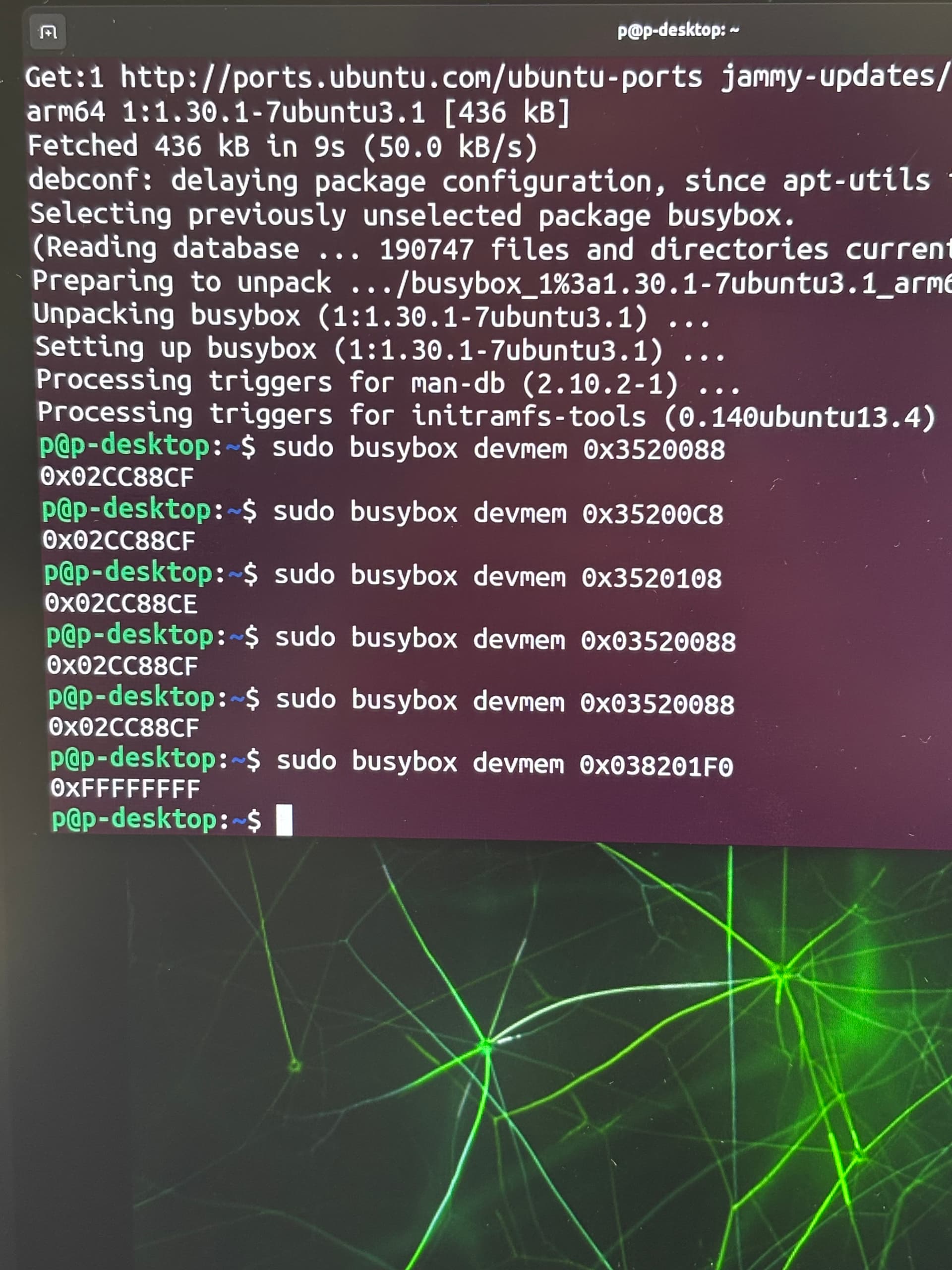

Issue 1: hs_curr_level_offset = 6 results in only a ~2 step change
After booting and checking register values with busybox devmem, we observed:
Before:
0x03520088 → 0x02CC88D1
0x035200C8 → 0x02CC88D0
0x03520108 → 0x02CC88D0
After adding offset = 6:
0x03520088 → 0x02CC88CF
0x035200C8 → 0x02CC88CF
0x03520108 → 0x02CC88CE
So even with offset = 6, the register only decreased by 2 or 3 (not the expected +6).
Issue 2: Reading USB_CALIB fuse returns 0xFFFFFFFF
We tried to read the USB_CALIB fuse:
sudo busybox devmem 0x038201F0
And it returned 0xFFFFFFFF.
Is this expected? If the fuse cannot be read, will the driver silently skip the offset calculation?

Where did you get this value 0x038201F0?
It should be 0x038101f0
0x038201F0是錯的. 請你用0x038101f0
另外上面這個nvidia,hs_curr_level_offset在Jetpack6已經沒有支援了. 請直接把你要改的address/value放到我上面講的prod setting裡面

我也有試過保留 board {} 包起來與否,兩者結果一致。結果觀察(透過 devmem 驗證):
Before:
After :
0x03520088 → 0x2CC88D8 這是預期的值
0x035200C8 → 0x2CC88D8 這是預期的值
0x03520108 → 0x02CC88CE 這不是預期的值
問題:
第三個 register (0x03520108) 寫入後的值是 0x02CC88CE,不是預期的 0x02CC88D8,目前還不確定是否被其他設定覆蓋,或是在 bootloader 某個階段被重寫

但不論將 mask 寫成 0x000000080x0000000F0xFFFFFFFF, apply overlay 後,值都變成如下:
我們預期只變更 bit 3,但實際卻連 bit 0~2 也被清除。請問這是因為 overlay 機制自動清除某些 bit?還是這些暫存器受限於特定硬體條件、無法透過 prod-setting 如期設定?謝謝!

我補充了一些 debug log,目前觀察到以下情況:
驅動在 tuning 寫入前讀到的是 PADx_CTL0 的初始值,這應該是 DTS 中 tegra234-soc-prod-overlay.dtsi 裡的 prod-settings 還沒套用之前的值。
value = padctl_readl(padctl, XUSB_PADCTL_USB2_OTG_PADX_CTL0(index));
	dev_info(dev, "[USB2 Tuning] Before write PAD%d_CTL0: 0x%08x\n", index, value);
	value &= ~USB2_OTG_PD_ZI;
	value |= TERM_SEL;
	value &= ~HS_CURR_LEVEL(~0);
	if (usb2->hs_curr_level_offset) {
		int hs_current_level;
		hs_current_level = (int)priv->calib.hs_curr_level[index] +
						usb2->hs_curr_level_offset;
		if (hs_current_level < 0)
			hs_current_level = 0;
		if (hs_current_level > 0x3f)
			hs_current_level = 0x3f;
		value |= HS_CURR_LEVEL(hs_current_level);
	} else {
		value |= HS_CURR_LEVEL(priv->calib.hs_curr_level[index]);
	padctl_writel(padctl, value, XUSB_PADCTL_USB2_OTG_PADX_CTL0(index));
        dev_info(dev, "[USB2 Tuning] After  write PAD%d_CTL0\n", index);
        dev_info(dev, "[USB2 Tuning]  Read back PAD%d_CTL0: 0x%08x\n", index, value);
        p@p-desktop:~$ sudo dmesg | grep "USB2 Tuning"
[    3.689134] tegra-xusb-padctl 3520000.padctl: [USB2 Tuning] successfully applied prod settings
[    3.689142] tegra-xusb-padctl 3520000.padctl: [USB2 Tuning] Before write PAD0_CTL0: 0x02cc88e8
[    3.689145] tegra-xusb-padctl 3520000.padctl: [USB2 Tuning] After  write PAD0_CTL0
[    3.689147] tegra-xusb-padctl 3520000.padctl: [USB2 Tuning]  Read back PAD0_CTL0: 0x02cc88d1
[    3.689514] tegra-xusb-padctl 3520000.padctl: [USB2 Tuning] successfully applied prod settings
[    3.689520] tegra-xusb-padctl 3520000.padctl: [USB2 Tuning] Before write PAD1_CTL0: 0x02cc88e8
[    3.689521] tegra-xusb-padctl 3520000.padctl: [USB2 Tuning] After  write PAD1_CTL0
[    3.689523] tegra-xusb-padctl 3520000.padctl: [USB2 Tuning]  Read back PAD1_CTL0: 0x02cc88d0
[    3.689549] tegra-xusb-padctl 3520000.padctl: [USB2 Tuning] successfully applied prod settings
[    3.689555] tegra-xusb-padctl 3520000.padctl: [USB2 Tuning] Before write PAD2_CTL0: 0x02cc88e8
[    3.689556] tegra-xusb-padctl 3520000.padctl: [USB2 Tuning] After  write PAD2_CTL0
[    3.689559] tegra-xusb-padctl 3520000.padctl: [USB2 Tuning]  Read back PAD2_CTL0: 0x02cc88d0
從 DTS 看起來,PAD0、PAD1、PAD2 都有設定:
padctl@3520000 {
    prod-settings {
        #prod-cells = <4>;
        prod {
            prod = <
                0 0x00000088 0x0000000f 0x00000008 // PAD0
                0 0x000000c8 0x0000000f 0x00000008 // PAD1
                0 0x00000108 0x0000000f 0x00000008 // PAD2
但實際 boot 完後用 devmem 讀的結果是:
PAD0: 0x02CC88D8
PAD1: 0x02CC88D8
PAD2: 0x02CC88D0 ← 這個值沒被改
想請問:請問這樣的行為是否合理?還是有其他建議可以進一步確認是誰在改掉?
