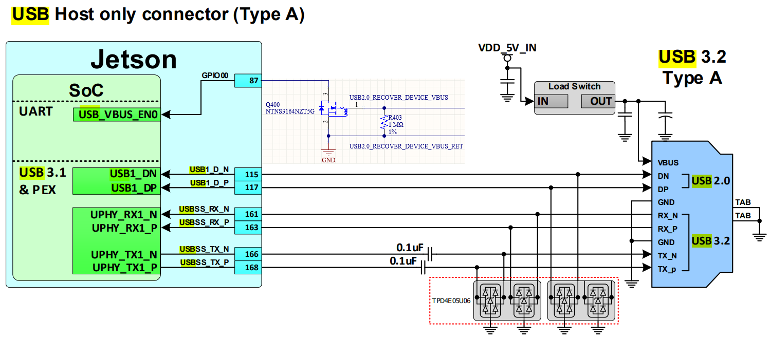

Does the DEVICE TREE USB SECTION listed above support the attached block level schematic? If not, would you recommend the changes that need to be made? Thank you.
@DaneLLL : The custom carrier card routes the Xavier NX USB traces straight to a connector without going through a hub. I modified the block diagram in the design guide to reflect that configuration. Do you see any issues with the Device Tree USB configuration previously shown and with the block diagram?
Trying to get the block diagram to work is what created the original topic. Changing the HS_CURR_LEVEL to 6 permitted most USB 2 devices to work. The Tuning and Compliance Guide recommended running the compliance test to determine if any parameters other than HS_CURR_LEVEL might need to be adjusted to adapt the Xavier NX’s USB interface to the custom carrier card.
Comparing to the reference design was recommended. If the reference design referred to the Xavier NX development board carrier card, then we don’t have a hub. In case the reference design referred to the product design guide, I took the diagram from that and tweaked it to show our implementation. I wondered if you thought our implementation was specified correctly in the DEVICE TREE USB SECTION we provided because we currently do not know how to make any compliance test related tweaks other than to HS_CURR_LEVEL.

And this design does not follow design guide and may trigger certain issue:
In our design duide, GPIO00 is output from module to a load switch to enable VBUS of USB1 port.
In the custom design, GPIO00 is used as input from USB0 port as VBUS_DETECTION, and the VBUS of USB1 port is always on.
Custom carrier card was modeled after development kit Xavier NX carrier card. Here, USB2-0 was used as recovery port and USB2-1 was a device port that was companion to USB3-2. The development kit Xavier NX was used for software development, and we switched to industrial grade Xavier NX for actual field deployment. We flashed the industrial grade Xavier NX. I need to go back and compare the development kit and industrial grade device trees for the Xavier NX to see if your “may trigger certain issue” is going to be problematic for me. I guess just stand by for the moment. Thanks for the feedback.
@DaneLLL , I’m looking at the USB ports and pads sections of the Device Trees for the development kit Xavier NX and for the industrial grade Xavier NX, and those sections look the same. However, the development kit Xavier NX uses GPIO00 for USB2-0 VBUS_Detection input, while industrial grade Xavier NX uses GPIO00 for USB2-1 VBUS enable output. Does mode = “otg” somehow allow the development kit Xavier NX and the industrial grade Xavier NX to both work in both the development kit carrier card and our custom carrier card? Or is there something else somewhere in the two different device trees that define differently how GPIO00 is supposed to work?
